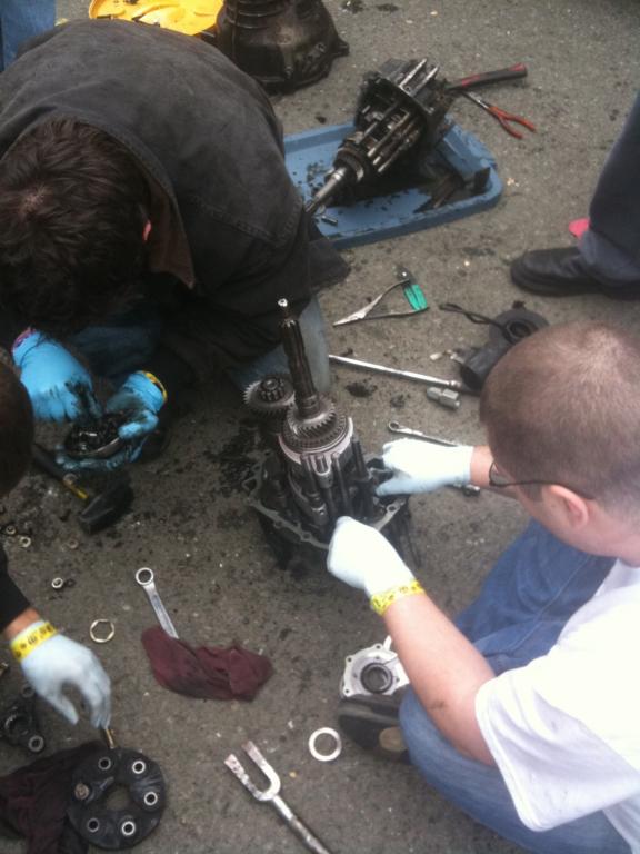

            So who here has gotten their car stuck in gear? Definitely just happened to me. Fuck!

                ^^ I don't believe so, because even with the car on or off and with the clutch engaged/disengaged, the shifter was stuck in 3rd gear.
                Rundown: shifted to third, went to go to 4th and the shifter wouldn't move. Was able to get in to a parking lot and fuck with it and tried to yank it out of gear, to no avail (and I believe I broke the shifter in the process, awesome.) Was able to limp it back to my shop in 3rd gear so I know the master/slave is fine.

                  #2093
                  I broke the connecting rod from the bottom of the shifter to the tranny. I was getting on the highway shifting to second. Ended up parking it on the embankment. left a note on the windshield. Ordered the part and slipped it in a few days later.

                    Sounds like a shift linkage issue to me too Austin.

                      #2095
                      Thanks guys. I'm praying that it's a shift linkage issue and not a seized trans :( One can only hope.

                        ^Is it a G240?

                          #2097
                          G260 trans with the M50 swap.

                                The exact same thing happened to us at a LeMons race. Not even smacking a mallet on the selector rod would get it out of 3rd. It jammed internally somewhere.
                                So we took two broken G260s and made one working one 8).
