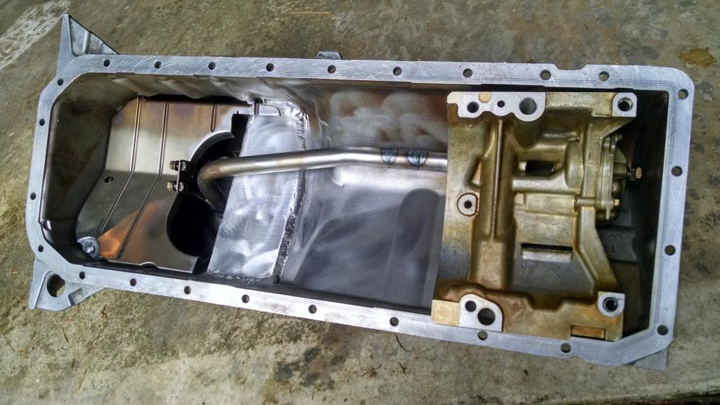

    Pan is back from Tyler. I'll have an improved oil pump shaft today and then I can get the bottom buttoned back up.

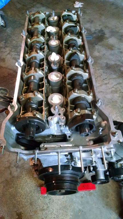

    I also have the cams. A Schrick intake and a Shrek exhaust.

      #77
      Upgraded oil pump shaft from Achilles Motorsports. No more nut to come loose and the shaft is tougher. They even pressed it into my pump rotor.

            #80
            Cams are installed.
            The intake is a Schrick 264 degree/10.5mm. Stock was 240/9.7
            The exhaust is a Shrek cam. 254 degree/9.7mm. Stock was 244/9.0

              #81
              Damn, this thing is going to be quick

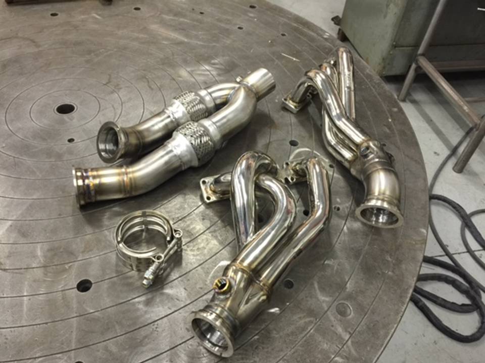

                As a bonus, the sway bar is relocated to the front and the subframe is narrower, so fewer issues with the headers. Raceland, in this case.
                Nice work by Tyler at the Arc Asylum.

                      I sent my headers to Tyler for some massaging. Once those get back I'll have the mechanical bits done and will "just" need to fabricate the Megasquirt harness before I can swap motors.

                          #87
                          Tyler is finishing my headers. Looks like I'll have those in a week or two. Pictures to follow, naturally...

                                #90
                                headers are in the mail! Tyler took a generic pair of Raceland headers and massaged them to fit properly.
