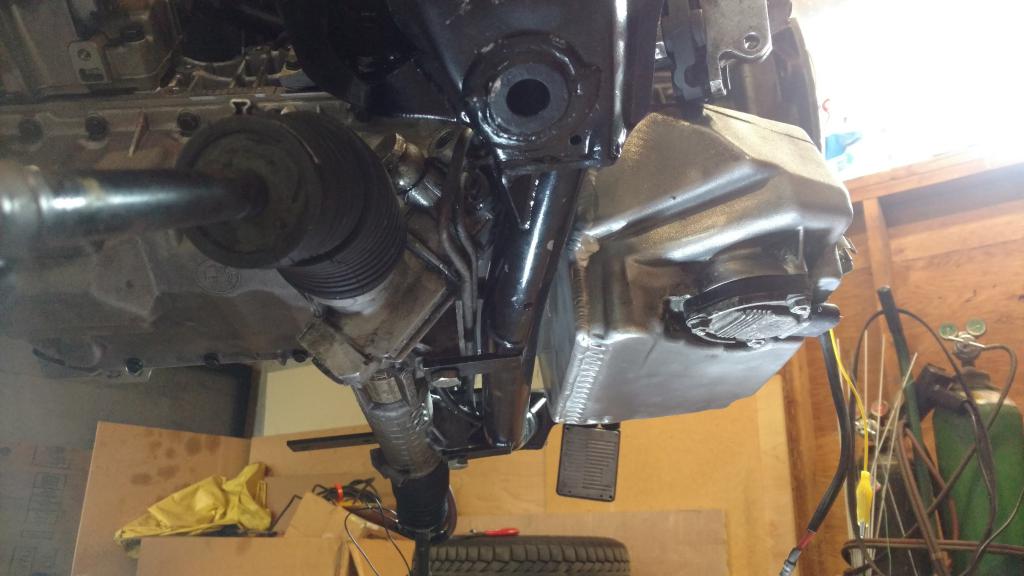

            Removal was quick and painless.
            My only mistake was that I overlooked the throttle cable and clutch slave line. No big deal...
            I found that the dolly height of around 4" left plenty of clearance to access all bolts once the engine was lowered to rest on it. I raised the body by placing one jack on each side of the body, under the rail beneath each door. It was necessary to tap and pry the subframe after the body was raised the first several inches because the alignment pins were causing it to hang-up.
            The engine was also not perfectly balanced on the dolly so it tipped a little.

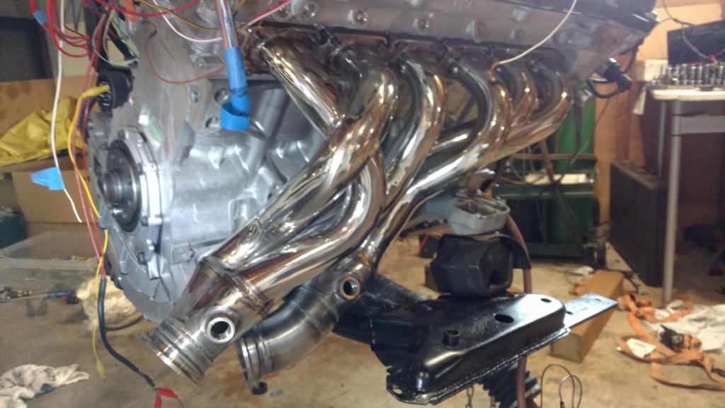

              I've had parts back from Tyler for over a year now, exciting to finally install them. Fortunately everything is fitting like a glove. Modified front subframe already has the tabs sized for e36 steering rack, no spacer required. I also sent him a pair of generic Raceland headers which got his blessing.
