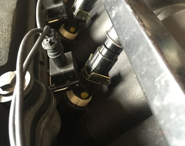

        Question: Is there a solution to the EV6 injectors leaking? I had one pop out enough while warming up the motor to spray a lot of gas on the motor. I swapped the stock M50 ones back in for now. The upper O-ring on my 24# injectors look slightly lower in the fuel rail bore than the stock ones. Do I need extra spacers in the manifold?
              I'm guessing you can't use the normal clips that hold the injectors to the fuel rail?
              Check out this thread, post 578 and 583. Looks like he has the same issue (not being able to use the clips) so he made some spacers to hold the injectors in place.
              http://www.bimmerforums.com/forum/sh...-9-inch/page24

                Some injectors have the groove for the fuel rail clip, some don't. There's nothing that the injector seats in when it goes into the M50 manifold bore, it can go down 6 or more mm, enough that if it works its way out of the fuel rail it will spray fuel until you BBQ the car.
                It looks like what he did is print some collars that give the injectors something to seat against, so they are squeezed between the fuel rail and the manifold.
                Out of all the people that have switched injectors I can't possibly the only one that's noticed this? Is everyone else just using injectors without clips??

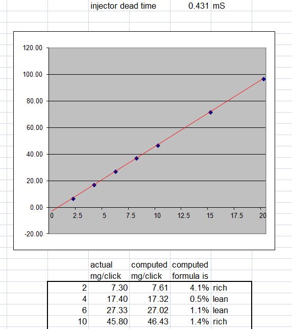

                  I characterized the flow on my -715 24# injectors and got some nice data. Nicely linear.

                      Did you figure out the injector spacers? Out of curiosity I googled it and it seems like someguy just 3d printed what is readily available to solve what seems like a pretty common issue.

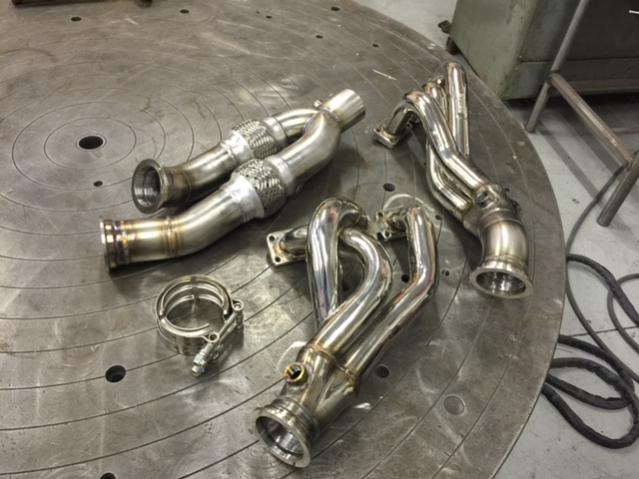

                      Also thanks for the euro headers :D they should be arriving today and I am extremely excited. Been trying to get my hands on a set for years but couldn't justify paying more for shipping overseas than for the headers themselves

                          As far as the injectors, I ended-up using a dremel to cut a groove in the appropriate place and it seems to be holding fine (although it still makes me a little nervous...).

                          I also miss the S50b32 headers. Tyler did an amazing job getting Racelands to fit like a glove, but they're loud and droney. I have OBD2 headers and mids to make it more civilized.
                            I doubt they make any more power than your Euro headers. The collector location just kills the low/mid range power.
                                Don't be. I have been doing this for years on turbo m20 builds. I use a fence in the band saw to make the grooves all the same height. There's a metal tube inside, where the filters are inserted, so cutting the plastic is non structural.
