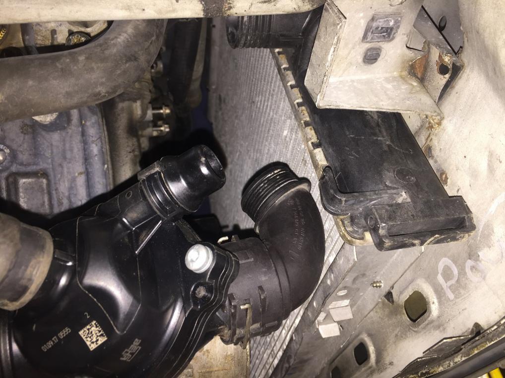

                    Pic loses the depth perception, but the lower radiator hose will be tight. I removed the index tabs on the plastic fitting, which will allow me to rotate to the best position. The elbow I am using is actually a 80-85 degree (angle) so it points it a little up and back from the radiator. I will just need a hose with a 90 and slight offset to work. This will not allow me to use the stock lower rad sensor, so I will have to see if I can get something together for that.
                    Heater/exp tank hose outlet on the thermostat is pointed right at the frame rail. So a 90 pointing up should work, and then I will need to splice a tee into it to branch over to the heating pipe.
                    I am using an e30 radiator, and so it doesn't have the push on fitting receptacle like the e90 would. Hasn't been a problem yet as far as getting everything to fit, although if present, would probably allow the stock sensor in the lower rad hose, and an easier upper rad hose setup. Just don't think anything more modern than an e36 rad will fit the e30 from what I've seen. Anyway, looks like I can make it all work with what I've got.
                    Nando, a thicker rad like the Z3M would make that lower rad hose an even tighter bend....would be close.

                      Couldn't you just mount the thermostat differently it's not so close? it's bolted to the pump normally, but I don't see why it necessarily has to be - you'd just need different hoses to connect it to the pump & block. that looks really close to me.
                      You'd probably want to keep it low (I think it's placed there because it makes bleeding easier), but otherwise I think there's some freedom to mount it differently.

                        You can really only go back about a 1/4"; any more and you will hit the water pump outlet. Other close areas are also limited, with the Ac compressor above, and the hose/steel elbow off the engine in back. So either a completely new location with all new hoses, or the approach I'm going. Looking at the front space between the rad and the thermostat with elbow attached like I've got it, there's about 1/2" clearance, so I think it will work fine. Just "modern car" clearances.

                          Yeah it looked closer in the pic - I agree 1/2" should be plenty.
