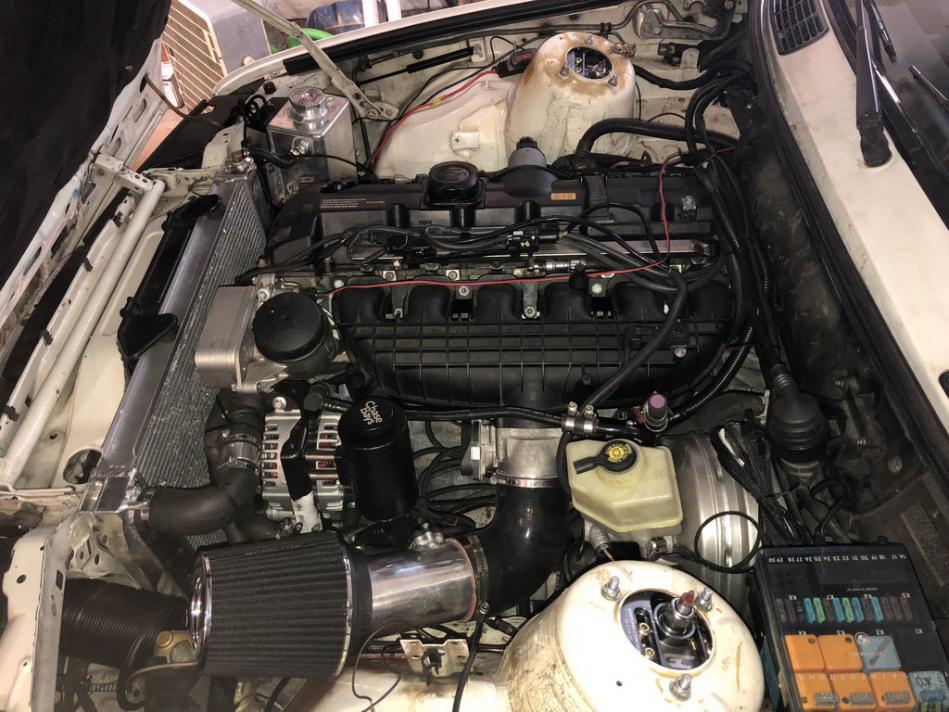

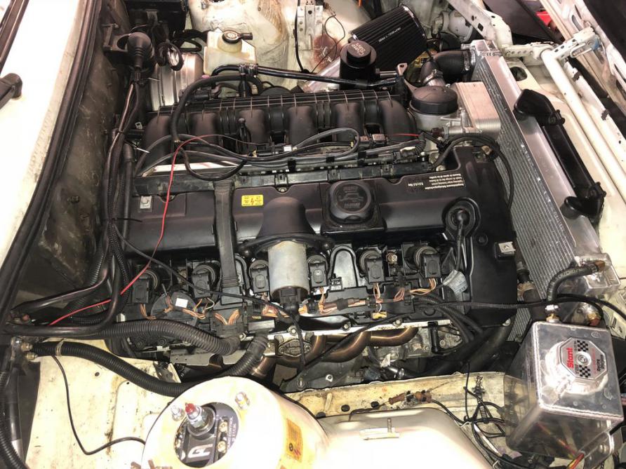

                I would like to see engine bay photos

                  #98
                  Here are a few pics. Still need to finalize the wiring and a few other bits, but mostly complete.
                  I will do a write up of the whole swap while its still somewhat fresh in my head. What is the best way to create a fairly long thread on this forum?

                      Which engine cover is that? N54?
                      I want to do something with the magnesium cover (powdercoat? polish?), and hopefully fit the S54 throttles with a custom (or CSL) airbox. I just never liked the fake plastic covers on newer BMWs, but I like the fitment/execution of yours.

                        Cover is off of a 2011 528i. Guess they changed it at that point. Even has a roundel in it like the hood badge..lol.
