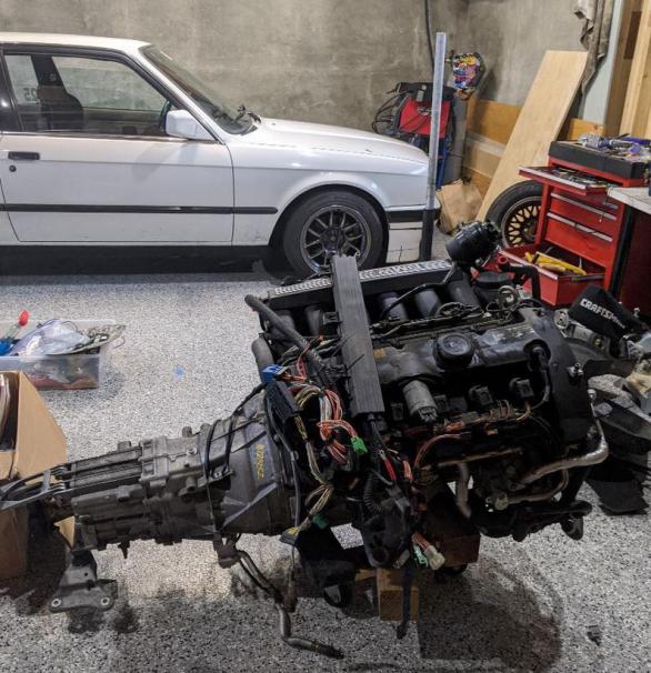

    I picked-up a 67k mile motor out of a 2010 328i with the help of this thread's host, Gareth.
    We compared his motor with mine and he immediately noticed that my transmission is 2" shorter. Turns out that I have a Getrag G6-17 and he has the G6-37. The difference is in the torque rating and the 37 was used on the slightly more powerful 330's. It's rated for 273ft-lbs while the 17 is weaker at 125ft-lbs. RealOEM has the 37 weighing 95.9 while the 17 is 74.5, almost a 20lb difference.
    Seeing as how the 17 is installed in the heavier 5 series, and that people have been upgrading their 328's to 330 specs for a long time now, I'm not worried about it, plus with an N54 intake I'll be making power by spinning the motor faster at about the same torque.
    One of the other differences is that the newer motor has the oil separation built into the valve cover, so no external cyclone separator and the required drainback into the pan.
    The entire package was only $2300. Cheap!

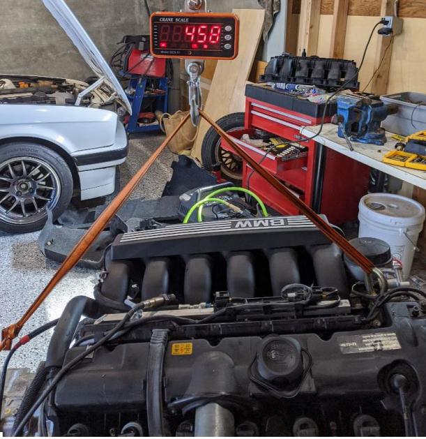

                          458lbs with everything except oil and exhaust.. Includes A/C, engine mounts, wiring, the shifter, G6-17 transmission.
                          M20+G260 is about 497lbs.
