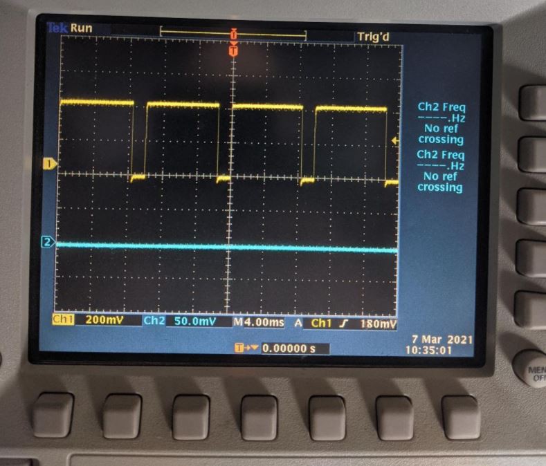

                                #495
                                On cooling...
                                So on my M54, as it was on the M20, I had a fixed 80C thermostat, which means my coolant temps ran somewhere around 90C/195F and my radiator outlet temps were around 82C. I had the standard 91C/99C aux fan thermostat switch and a SPAL pusher fan.
                                In normal driving the temp gauge was somewhere just to the left of 1/2 and if I was in slow traffic or at a light it would creep above 1/2 and trigger the aux fan low speed. All was good. (BTW, I never, ever had an issue cooling the M54 with the stock radiator, even tracking on hot days...)
                                The N52, however, is completely different...
                                I've had the chance to drive it a bit now and observe its quirks. First, it has a 97C thermostat which means that normal operating temp is around 105C/220F and it can also slip into "eco" mode.at 112C/234F or down to 95C, depending on what I'm doing. So, the gauge can be settled at 1/2 and then spontaneously start moving to the right if I'm not hooning it. it's kind-of disconcerting and probably why the modern temperature gauges just tell you that things are "normal".
                                Anyway, this means that with an operating temp of 105 my radiator outlet temp is around 95-97C, which clearly triggers the aux fan. Sometimes I even trigger aux "high" at 99C.
                                What seems to happen is that the aux fan and the ECU end up fighting each other. The aux fan kicks-on to drive down temps, but the ECU is determined to raise them so it just reduces coolant flow. The aux fan ends up running all the time, even at highway speeds.
                                So, I need the aux fan and the ECU to coordinate with each other. If only there was a way to do that...
                                To start, I connected C101 pin 14 VSS with 6001 pin 17 speed input and verified that the ECU is registering road speed, I think that's a critical parameter in how it controls the aux fan. I put the car on jackstands and at 40mph the
                                Geschwindigkeit was 63kph. Sweet!
                                Next, I need to see about getting an aux fan module and seeing how that integrates with the ECU and the SPAL.
                                As a final note, early N52's have a radiator outlet temperature sensor, but the later N52K's do not. I think the later motors just assign an outlet temp that's 7.5C lower than inlet. Since my flash isn't necessarily from a late motor, I may or may not need to add the outlet temp sensor to make everything work...
                                As a final, final note, the cooling parameters have tables and can be mapped like anything else, so there is a degree of software control that's available, but I'm not sure how I would change it.
                                For documentation, this is the PWM fan signal. It's a 5v signal that's pulled down to ground (open collector), 100Hz. This is 15 percent duty cycle. Some PWM fan controllers are setup for this signal and some are reversed polarity, where duty cycle is time at 5v instead of ground..
                                Click image for larger version  Name:	Capture.JPG Views:	0 Size:	107.9 KB ID:	9977659
