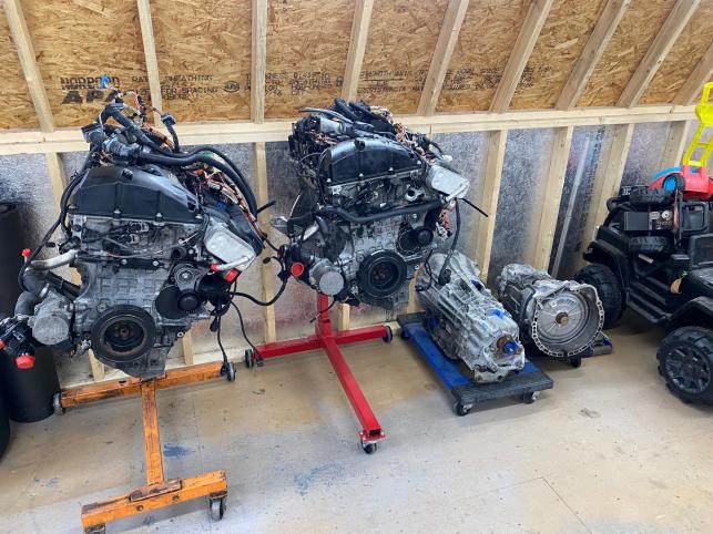

          Well my buddy and I are officially aboard the train. Picked up 2 N52ks and 2 DCTs this weekend.
          With how affordable standalones have become in recent years and the fact that these are race cars with no need to integrate with anything factory at all we're thinking its going to be best to go that route. Hopefully anything we learn with respect to making power and keeping the engines reliable on track will be relevant to others in this thread.
          As far as the timing is concerned we're likely going to key the crank hub like Nando suggested. It seems like the most foolproof solution and I'll be sure to get some pics when we get there.
          The only thing I'm hung up on with respect to standalones is I'm not sure I'm going to be able to run valvetronic. The other N52 race engines I've been able to find on the internet have all locked the valvetronic at max lift and either used an N54 manifold and throttle body or ITBs adapted from a euro S50 or S54. Are there any performance losses by not using valvetronic? I think the system is really cool and it kind of makes me squirm to think about bypassing it, but it's beginning to look like a standalone with DCT or valvetronic with MSV70 and we're committed to getting the DCT to work. It's going to be absolutely amazing in the race cars.
          How is the stepper motor that controls valvetronic functionally different than a normal TBW throttle body like in an M54 for example? Looking at how valvetronic works it seems to me it should be similar.

            I mean, MSV70 is pretty easy to work with. And it definitely reports the values over CAN that would be needed. My only hesitation is have never seen a factory DCT car with an N52, but I know they exist (just not in the US). So I have never messed with any of those parameters. Manual is easy because the driver does the shifting and you don't need to care about it while tuning, lol.
            You could mechanically lock the Valvetronic to full lift and use a normal throttle of course, which a few people have done. You definitely can't control it like it was a throttle body, there's no linear relationship between pedal input and valve lift.
            I don't think you're going to get any standalone that is going to control it properly either - the factory software is insanely complex, especially because it has to be 100% safe to avoid uncontrolled throttle output. Even if somebody advertises Valvetronic support I'd be extremely skeptical.
            I'm not sure how locking it affects the torque curve, but one of the advantages is you control lift so you can keep intake port velocity high at all times. I assume WOT power would be the same but you might give up low end torque, which is maybe less important on a race car.
