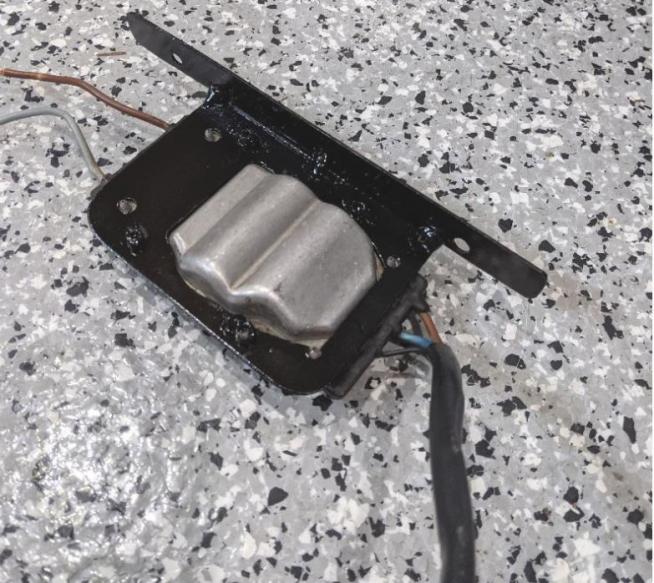

                  So from my post above you've gathered that the thermostatic cooling fan and the MSV70 fight each other, and the MSV70 wins. It just says "fuck you" and reduces the coolant flow leaving the aux fan running, needlessly and loudly. I connected the VSS to get a valid road speed and also identified the wire for the fan activation. Not all PWM fan controllers will work, it needs to be one that works on a PWM negative signal. More ground=more blowing. Fortunately, the e46 has a nice little module built into the fan cassette.
                  Luckily, I had a bracket laying around that fit the module perfectly and mounts it on my stock fan frame that now has my Spal fan. BMW seems to want this prominently in the airstream so tucking it behind the headlights wasn't an option. I sourced the body side of the harness that the fan plugs into, and I could almost have literally just replaced the e30 plug with the e46 plug, it fits that well.
                  The e46 module gets wired to the battery and is controlled by the PWM signal. Since the stock aux fan has both a low speed and high speed power wires, I just combined those two together and used them for power. Those wires are connected to two relays that are controlled by the thermo switch, so I shorted the harness at the thermo switch so both relays energize with ignition.
                  In practice, it works perfectly.

                    This ECU fan control pleases me. I expect that this is exactly what I'm going to be doing, with an additional override after the fan control box that puts my fan on high speed when my AC compressor clicks on. I won't have any feedback issues with an override switch... the thermostat will just behave as designed.
                    I'm currently extending and appending a Z4 wiring harness to suit the chassis (documentation to follow) and I want to confirm what we'd previously discussed related to the MAF/IAT sensor, because I have a pin number mismatch between the connectors on the X3 and Z4 harnesses I'm combining. Here's the BMW diagram for several of the N52 engines:
