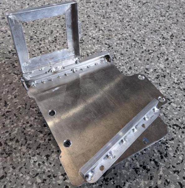

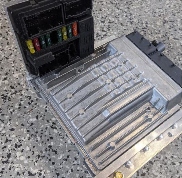

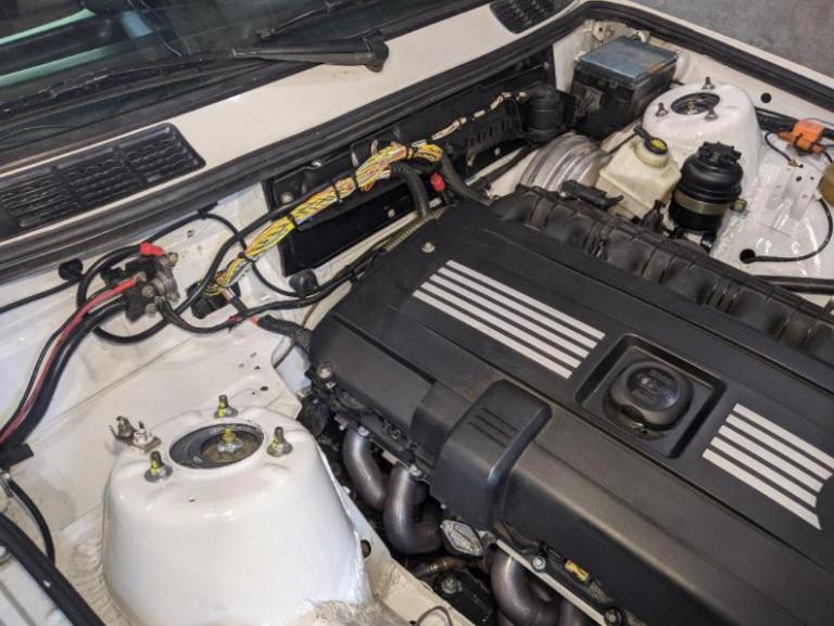

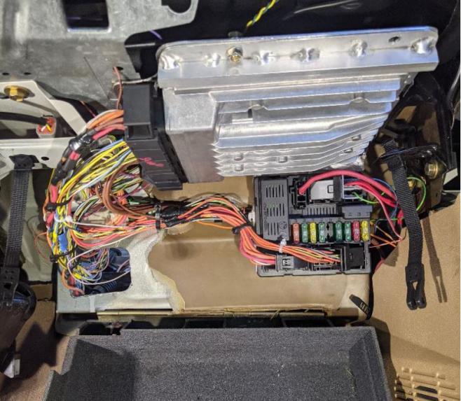

    Small update just to show how I ended-up mounting the ECU and IVM. It will be even neater once I'm done optimizing the wiring and zip-tying. I'll have a separate post on what I used for the wiring harness later.

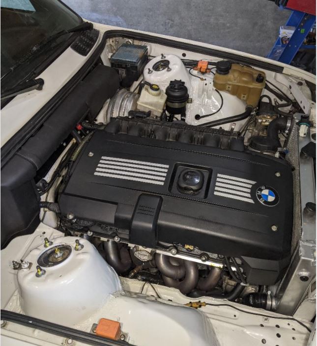

      I'm pleased with how the engine bay looks, it's come a long way from the wiring shit-show when I first had it running! This is using a Z4 harness. I highly recommend Z4 as the base harness because of the IVM, which replaces a tangle of plugs, fuse boxes and relays with one simple, svelte little box. It combines all the relays, fuses and plugs and makes things a lot easier.
      Now, the drivers side of the Z4 harness is too short to reach the glovebox, but the e90 harness is perfect, so I swapped all the wires on that side from Z4 to E90. It's simple, trust me, only takes an hour or two. On the passenger side, the Z4 harness is 2 1/2 ft too LONG, but there's not nearly as many wires and they're quite simple to shorten.
      Pictures with and without the M3 beauty cover.

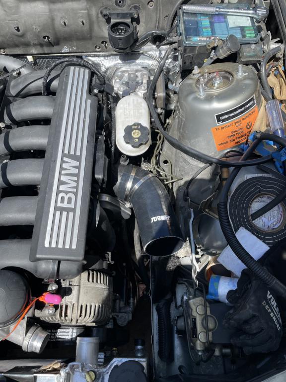

                  "Cause if you liked it than you should have put a MAF on it..."
                  or something like that.

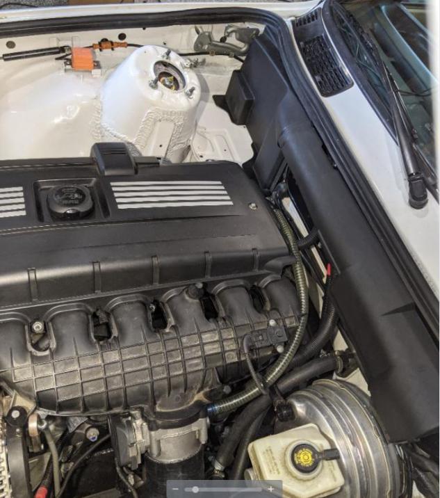

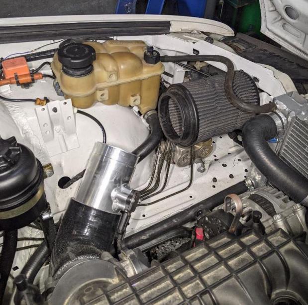

                  Yes, the consensus was that I needed a MAF to go from engine model inferred airflow to measured airflow, and what a difference! Whereas before it was rough, hesitated, had flat spots and was no fun to drive around town, the MAF made it perfectly happy pulling from 1000rpm in 5th gear.
                  This is a 3.25" MAF to match the N54 throttle body.
                  HELP NEEDED. My intake temps are awful with my hot air intake. What are the cool kids with ABS doing for cold air?

                    No that I've purchased, but you'd probably want something like this: https://castromotorsport.bigcartel.c...ce-air-box-e30
                    Which puts the filter almost above the ABS unit, and boxes it in there.
                    I'm sure you'd be able to make something similar like this guy: https://www.bimmerforums.com/forum/s...34#post9817834
                    • Victell
                      • 1083
                      #550
                      Originally posted by hoveringuy
                      This is a 3.25" MAF to match the N54 throttle body... What are the cool kids with ABS doing for cold air?
                      If you dont mind stepping down to 3" then it looks like the Kamotors intake kit would fit.
                      • nando
                        • 34847
                        #551
                        MMMmmm, hot air intake! :p
                        I have a KAmotors intake on my M20. Ehhh.. we can figure out something better than that. But it at least shields the filter I guess. I think most people though, just run an open filter. Heck, amost 99% of N54/N55s I see with mods have the open filters right on top of the engine.
                        If you could get that elbow/filter a little higher and closer to the headlight, it wouldn't be too hard to form something with a sheet of ABS or something, at least to shield it from direct airflow off the radiator.

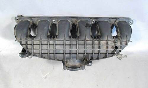

                          #552

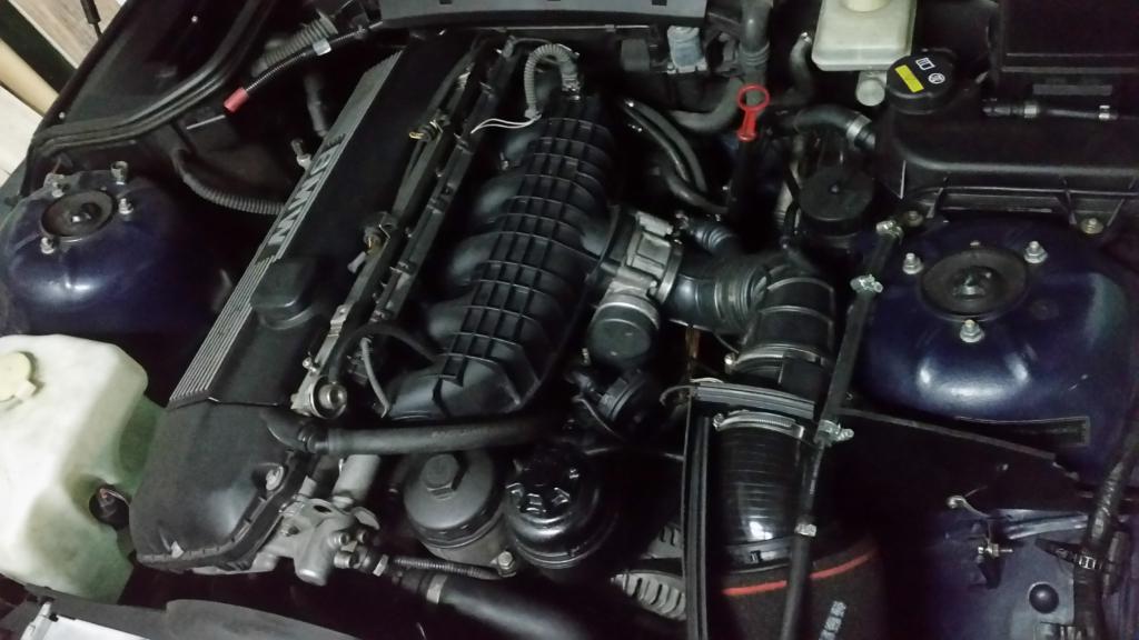

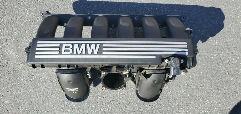

                          The N54 manifold creates a challenge because of the angle of the throttle body:
                          vs the N52:
                          I think you need to turn up before you start moving forward so you get over the pump, even if that means moving the PS reservoir. This is another frankensteined engine combo with an n54 manifold, but I don't know what factory rubber piece that is on the N52 throttle body:
                          That's from a recent post over here if no one else recognizes it: https://www.romraider.com/forum/view...p?f=60&t=16947
                          How much angle do you get out of the factory n52 plastic elbow? I bet you have one of those.

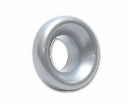

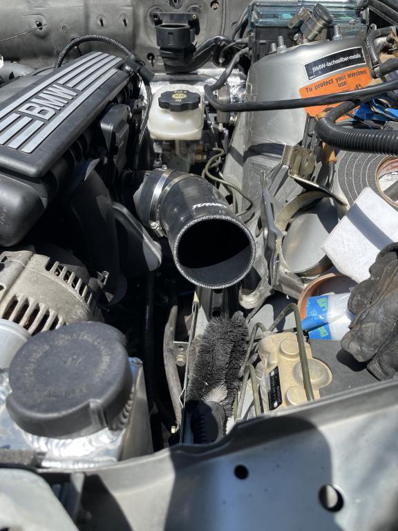

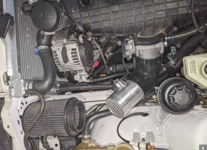

                            I think I'll do an "all of the above" approach.
                            -6" spun aluminum venturi to replace my high beam
                            -With a 90 at the TB, 3.25" MAF tube, and then either a 45 or 60 (I ordered both...), I should be perfectly aligned to have the filter over the ABS
                            -I'll put a divider between the radiator outflow and the filter.
                            The N54 TB is bigger than N52, so the N52 intake stuff doesn't fit.
                            Like a lot of things, I think this will be my "rev 1" version as I discover what works and doesn't work.
                            I don't really get the Castro style box; once the corner is sealed-off, where's the air coming from?
