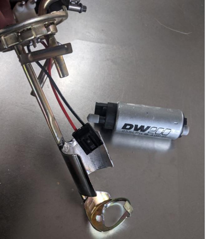

      My fuel pressure was 6 psi short of 5bar, and my stock fuel pump was very noisy, so I installed a new Douchewerks DW200 with the 9-1031 install kit. This is supposed to flow 210 liters per hour at 5bar while drawing 11 amps.
      For the install you're supposed to just use a hose clamp to attach it to the support rod, but I didn't think that was secure enough and added a bracket, because I love brackets. I also didn't use the supplied accordion flex line and used fuel line instead. My other hints are that the pickup was hitting the bottom of the tank if I lowered the pump all the way to the bottom, and the position of the clamp is important so that it doesn't hit the fuel transfer tube inside the tank. The filter sock was clocked to the correct position for the tank, however.
      It's quieter than my stock pump and boosted the rail pressure.

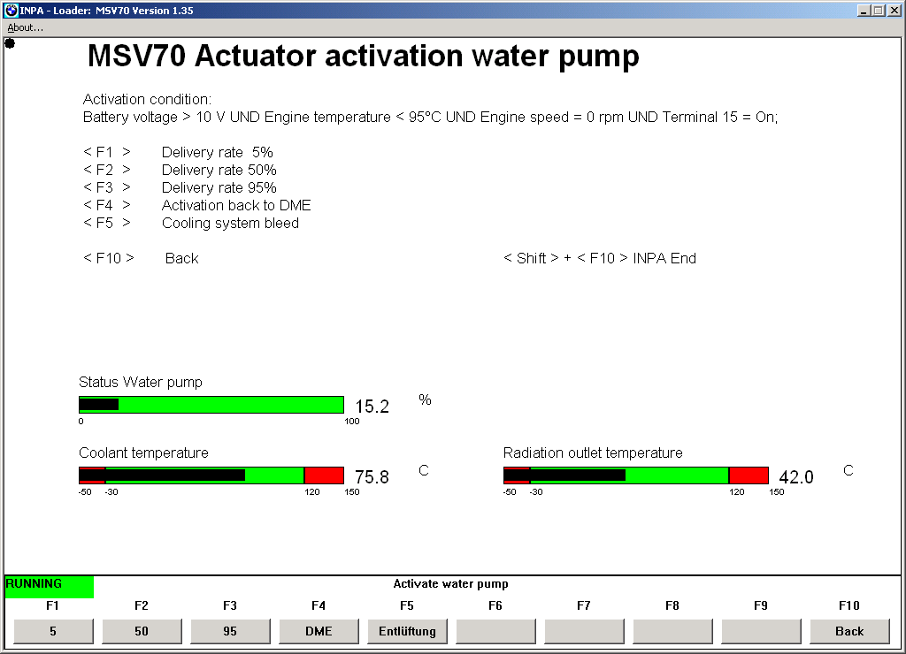

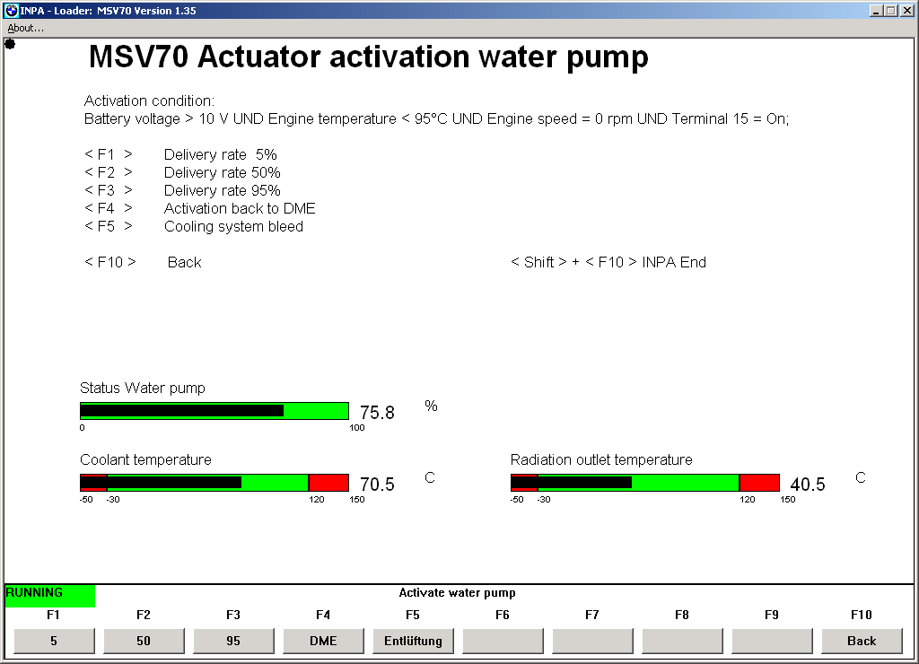

        I haven't had cabin heat up until now and was getting tired of cold feet, so I finally plumbed it up. Some things are different on the N52, but the primary cooling loop is basically the same. Hot coolant leaves the engine, flows through the radiator, is metered by the thermostat and then pumped back into the engine. I fabricated a small manifold to tap the engine outflow and send it to the bottom pipe of the heater core.
        It absolutely sucks!
        No warm air even when at operating temp at idle. I did get a small amount of hot air when I did some driving. What's going on?
        As an experiment I triggered the coolant pump to 95% through INPA once I was back in the garage and got a plethora, a veritable gusher of hot air. Like, a lot!
        So, I think what's happening is that the engine doesn't know that I'm trying to make heat and runs the coolant pump at low speed which isn't pushing anything through the heater core. Need either 1) an aux heater circuit circulation pump or 2) a way to tell the ECU to ramp up pump speed for heat.

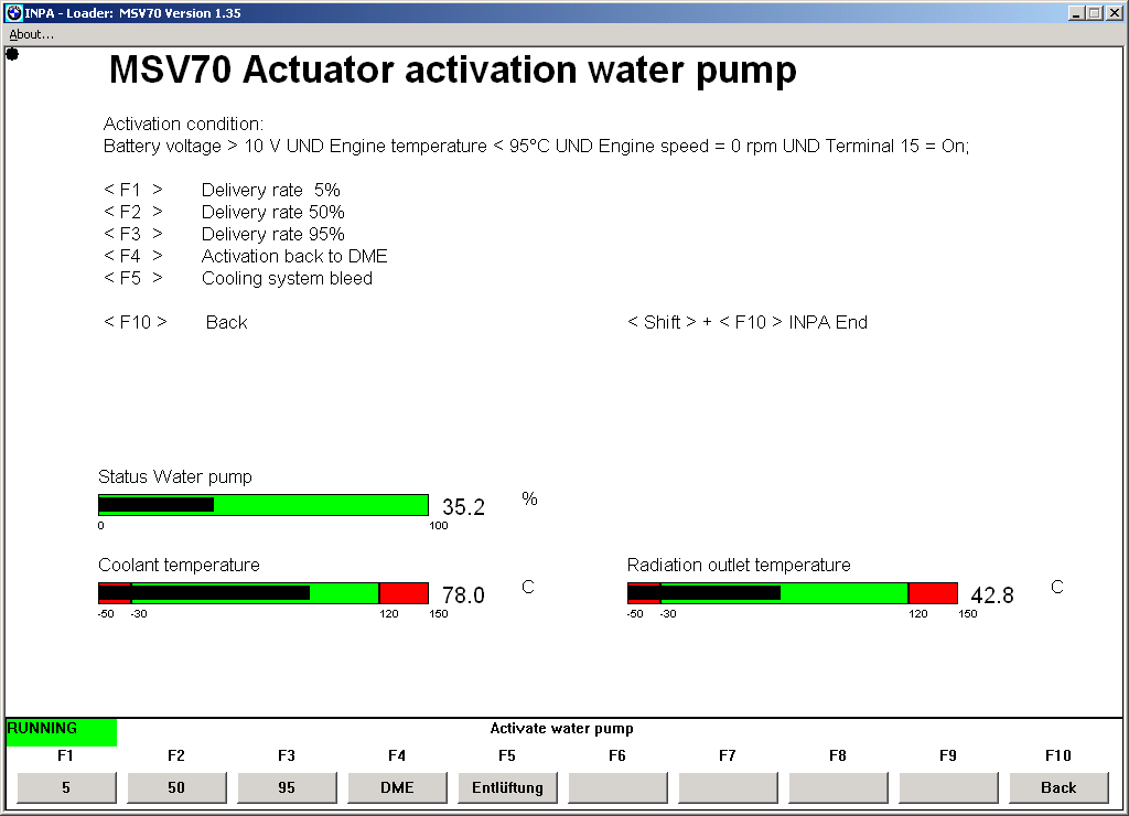

                  Looked into the heat situation and I think the solution is pretty simple (at least as far as work-arounds go). No external pump is needed, indeed that would be silly as the waterpump can flow regardless of if the engine is on or off (N52 cars even have an HVAC button specifically for this). I haven't looked but I sort of doubt that E60s with the N52 have a separate pump just for that when the stock N52 pump can already do this.
                  I took screenshots of the pump operation in 3 states - at idle with the heater at full blast, the heater off, and also with the engine off and the heater on max (REST). That should tell me the typical states of the waterpump operation regarding heater controls.
                  here's the heat turned off - minimum pump speed is 15% at idle:
                  here's the heat set to max (84 degrees) - pump speed is at 76%:
                  Here's with the engine off, and the heater at max (REST) - pump speed is 35%:

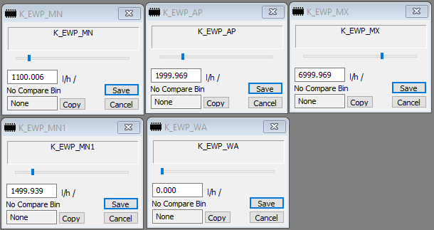

                  Now, the pump is controlled with thermal load. There's not really a map, but a set of constants
                  (K_EWP_*). the DME uses demand to decide how much to operate the pump on the fly. All are in units of liters/hour - the N52 pump has a maximum capacity of 7000l/hr:
                  Suffixes:
                  MN = min - the minimum pump flow with the engine warmed up.
                  MX = max - the maximum pump flow
                  WA = warmup flow rate. Notice the pump is turned off entirely during warm up. This helps to warm up the engine faster.
                  MN1 = This is the min pump flow at start with an already warmed up engine. We probably don't care about this, it's just designed to get the coolant flowing until the engine is in a "normal" state (there can be hot pockets when you turn off a hot engine etc).
                  AP = it's not actually clear from the code or the description - but I think this is the base flow rate for using the REST position
                  So basically, I think if we increase the K_EWP_MN to about 2000l/h, that should give us about the minimum speed needed to run the heater. This is a workaround without needing CAN inputs of course - and it would be easy enough to switch this value back to stock for a "summer" tune.

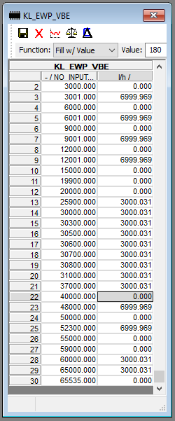

                  Also I found this interesting - this is the map for running the pump while bleeding the coolant system:
                  The Y axis is pump flow and the X axis is time (not sure of the exact units, probably CPU cycles or something). If you've ever bled an n52 engine before, this graph will make a lot of sense..

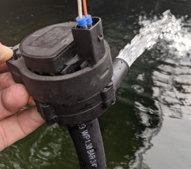

                      I received my Plan B in the mail today. (maybe that didn't come out right?)
                      Anyway, I received my Mercedes aux pump. It fits into my coffee mug and pumps a measured 1600 liters/hr. Dead silent.
                      Here's the mind-blowing part. 1600 litres per hour is 23% of 7000 litres per hour, or the main coolant pump running at 23%. So, 2000 liters per hour will cover this pump and plenty for flow through the radiator.
                      It probably won't go in the car but the Koi love it!

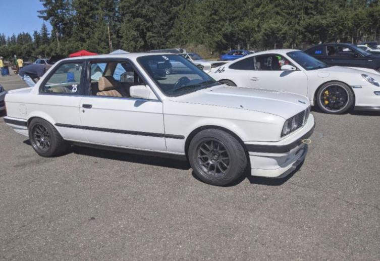

                        First track day of the year! So how did it do?
                        First, Nando, was nice enough to update the tune to both make the water pump run slightly faster, so I had cabin heat, and fix the radiator outlet temperature so that the aux fan worked properly and I had cooling. Both of those worked GREAT.
                        Overall, the motor was down on power from the M54 I had last year. My speed at the end of the straight was down from about 129 to 124 and it didn't pull as hard out of the corners. The M54 dynoed at around 245 so I'm guessing it's at 225-230whp presently. Power also got a little flaky after about 6200 and it didn't pull as hard on the top end as it should. It also used a lot of gas. I could run four 11 lap session with the M54 and still have gas to drive home; the N52 left me on "R" at the end of the third session.
                        So, the motor is running in limp mode, which means that the timing has probably been pulled back quite a bit which explains the power and probably the gas, too. This will be fixed.
                        The good news is that there were no other hiccups. The temp was about one needle width to the right of 1/2. No oil pressure issues, ZERO leaks. No banging, exhaust clearance or header heat issues. Started instantly, idled smoothly, sounds awesome! My driving was splendid, obviously.
                        On deck: I'm pulling the entire engine wiring harness and swapping in a Z4 harness and IVM that will clean things up considerably. Once that's done the final hurdle is for Nando to figure out the maps and braniac stuff to make it run right.
