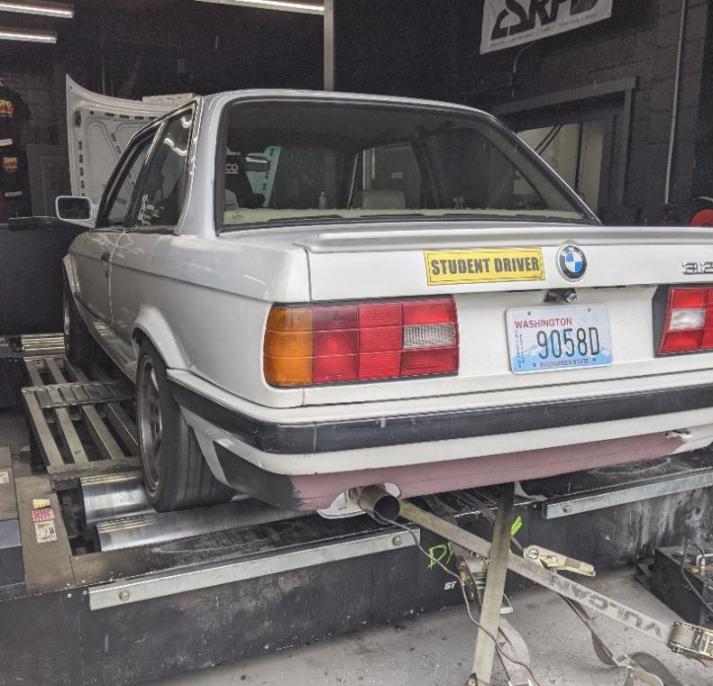

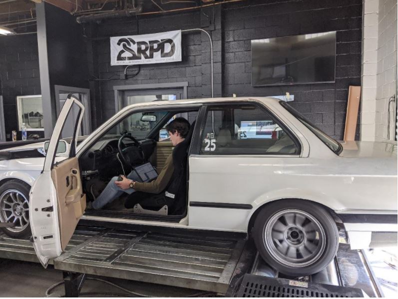

                So yesterday we followed the dyno to the end of the rainbow.
                The car had been just "meh" at the last track session. Speeds were down from the M54 and fuel consumption was atrocious, but it ran smoothly otherwise.
                Took it to 22RPD "22nd Race Product Development" and the baseline pull showed 189 whp and the A/F was pig-rich, like 9.
                Now, these guys tune BMWs all the time and make some awesome high-horsepower cars. They know ECU's as well as almost anybody, but and even they had a hard time with it. There are a lot of different maps and operating modes in the MSV70 and they struggled with finding the best way to make corrections. Ultimately, after lifting the torque limits they adjusted the global fuel scalar which was effective. There's more work to be done, however.

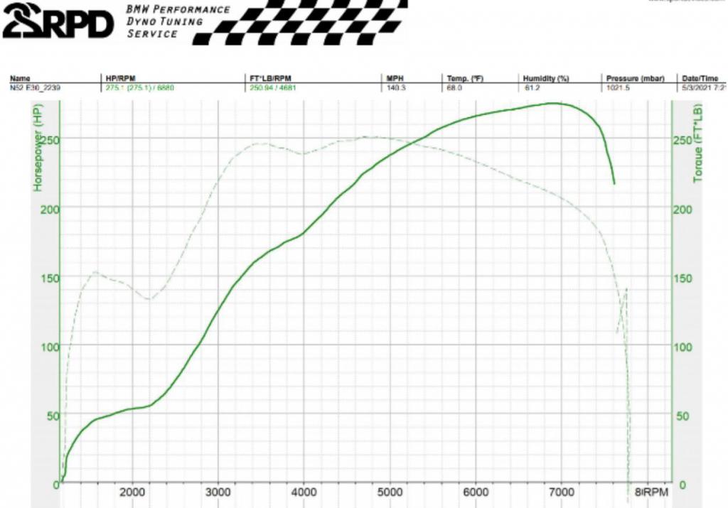

                The graph I'm showing here shows a peak of 275whp at 6900 with torque 250 at 4700. In reality, the motor keeps pulling well into the 7's and we saw up to 288 at 7500. If we had lifted the rev limiter to 8000 I think we would have seen 300. S54 headers work that well.
                There's still one little rough spot at around 2400 rpm that needs some future work but I'm pretty happy with it.

                  Get me a dump of the calibration in PAsoft - should be 0x8400000 - 0x85FFFF (same mode as dumping ram). I can start looking for that spot at 2500rpm.
                  It's pretty impressive considering the engine is entirely stock internally. I always knew these had a lot of potential. You could do MILVS and different exhaust cam rockers (basically the same thing as a cam swap), I bet that'd get to 300hp, but honestly with 288hp at 7500rpm, I doubt it would be worth the trouble.
                  the 3-stage is probably better suited to the bigger cars, but the torque you're getting is plenty for a little E30. The downside was getting it all in tune since the intake/exhaust are so different from stock.
                  It's just cool that you can basically get to the power of a stock S54, but with the weight of an M42 (or less, actually).

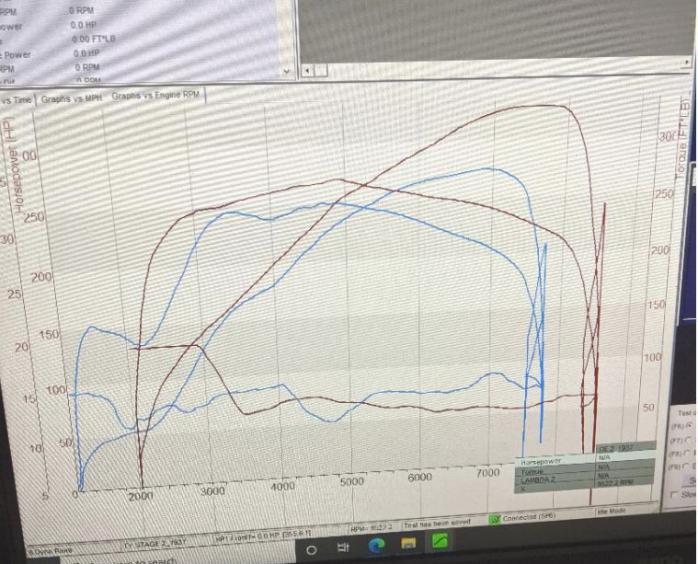

                    Here's compared to a highly-tuned S54 (not sure exactly what that entails..). That motor is putting down around 330whp, it's just not a fair fight. On the other hand, I also weigh 800lbs less.
                    Also compared it to a hot M54, which peaked at 250whp at around 6700 but had a better bottom-end.
                    Everyone at the shop was very surprised at what an N52 could do, for sure.

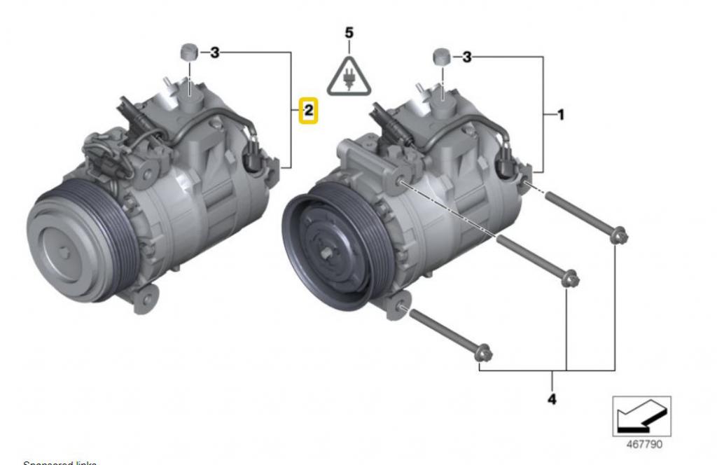

                          Originally posted by Caperix
                          Looking forward to how your lap times improve as you get everything worked out.
                          I did learn something new about n52 AC compressors by getting an incorrect part today. Apparently some 2011/12 e92 328's got an AC compressor with a clutch. The part number is 64 52 6 918 749, the car I was working on had the standard clutch less compressor so I do not know if there are any climate control differences.
                          This is something I found and came to conclusions about... but can't reproduce them. The difference is shown here: https://www.realoem.com/bmw/enUS/sho...94#64526918749
                          These are labeled as with magnetic clutch, and without magnetic clutch... and boy does the diagram look like that's the case. The reason I didn't pursue this is that there's no difference in the wiring on these cars, so the part that I cared about (how to activate the compressor when I wanted A/C) was still an issue. I *believe* that this was a late hardware revision to the compressor to save wear on the bearings during periods without A/C demand, which was a shortcoming of the original design, and this was done by having the pump itself activate and deactivate the freewheel clutch with its own internal (well, external) wiring.
                          I believe these are both variable rate compressors and thus...
                          The signal *to* the compressor is the same - probably PWM - signal for either unit, as is the plug. We could wire the compressor clutch directly (probably) and engage it with the e30 body harness, but the variable pump would be in whatever it's resting state is, which I believe is 0%, resulting in a very confusing installation where the system charges and the pump cycles on but there's no pressure change from the compressor.
                          For people who are reading this for the first time, the M73 compressor shows up on page 20 of this thread.
