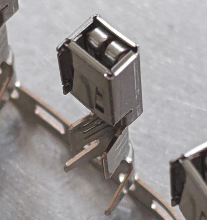

    I wanted to document the pins I used for wiring, I mentioned to Luke that I tried to avoid splices to a fault and I did that largely by re-terminating wires with the MSV70 and IVM pins to the largest extent possible. The proper crimper for the job cost like $1000, but any pair of needle nose works fine and I put a tiny dab of solder to make sure they didn't pull loose (don't let solder wick up to where the wire insulation is held)
    The connectors come in 3 sizes and are in the Tyco Micro Quadlock series, MQS interconnect system. See Catalog 1307999.
    The smallest is used for signals such as temperature sensors, eccentric shaft, crank position and such. Tyco PN 928999-1 Digikey P/N A123797TR-ND
    The medium one is used for things like injectors that draw some current but not too much. These are MQS 1.2 series. Tyco PN1355553-1 or 1355556-1. Digikey doesn't seem to carry these.
    The large ones carry power for O2 sensors or VVL motor, etc. These are MQS 1.5 series. PN 968075-2, Digikey has them as A122193TR-ND

      I'm pretty sure the crimpers I have will work just fine for those, they were like $40. I can't remember where I got them now, I'd have to dig way back. I use them for basically all the BMW wiring I've done, they work on all but the tiniest Tyco pins I've tried so far (I have another set I use for those). Actually I'm pretty sure I have some of those pins too, lol.
                          The generic crimpers are not perfect but its way better than just using needle nose pliers as it gets the generic shape correct. I usually make a light crimp to get the shape set and then use needle nose pliers to make sure it pinches tight enough one side at a time.
                          Is it perfect, no, but very close if you have patience. Also the crimping tool helps get the bends in the right place so the shape of the plier crimped pin is not too big to fit in the slot in the connector :)
                          Im spoiled because I have the real crimpers at work in our lab so everything else just feels like poo in comparison.

                            My crimpers are actually pretty nice, the only real issue is ergonomics. I've probably done thousands of pins with them, but as you can imagine - not exactly good for the wrist. I know there's an updated version with better ergonomics. I kinda wish I had bought them now, although I ended up stopping making harnesses for people as it's just not worth the hassle (I got burned on a somewhat infamous S54 harness build, it hurt my wrist, and it cost me money in the end - screw it).

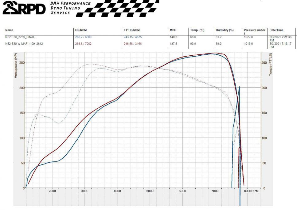

                              Update.
                              On the last episode, we had a pretty good track day with the MAF. Motor was running smooth even though it was a little down on power.
                              After another few days on the dyno, it's finally living up to all of its potential.
                              The baseline dyno showed that, indeed, it was a bit down on power at only 242hp/ and 227ft-lb. It had made around 270hp with no MAF (and no air filter...) and I expected to to recoup most of that, but expected a penalty for the MAF and the filter.
                              By playing with the timing and VANOS they were able to get it back up to 268hp and 246ft-lbs. It looks like there's a dip in torque at 2200 and 4000, but I think that the headers are just so strong at 3000 that it only appears that way. Drives great, pulls noticeably harder now and has an amazing amount of torque down low that makes me question why *anybody* would want a DISA intake on the N52.
                              The first chart is the before and after with the MAF.
                              The second chart is the no-MAF vs MAF plots, and how the MAF completely solves the ridiculous torque dip.
                              The chart is SAE corrected and calibrated to match Dynojet.

                                Would it continue to make power until an 8k redline? I think you said it was torque limited somewhere. It's not that far off a stock S54. and this is with all stock internals...
