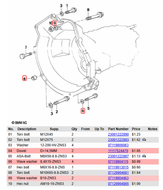

                  I'm still waiting on a number of parts to start digging in, but there's some auxiliary things I can do in the meantime.
                  I realized that I should probably do the clutch and diff now as I need to break in the clutch and doing that while simultaneously trying to tune the car isn't the best idea. Was hoping to figure out all of the 'while I'm there parts'. So far I have most everything but if anyone has any ideas on other things I should get while the transmission is out, let me know.
                  • Clutch
                  • Pressure Plate
                  • Resurface flywheel
                  • Master Cylinder
                  • Slave Cylinder
                  • Clutch line/grommet
                  • Clutch fork pivot
                  • Pilot Bearing
                  • Throwout bearing
                  • Wave Washers and Dowels below:
                  • Click image for larger version
                  I've already done a lot of the common items like Giubo, transmission seals, center support bearing, rear main, etc.
                  https://www.instagram.com/shts_fkd_g...l4ZmRsajFlbjh2
