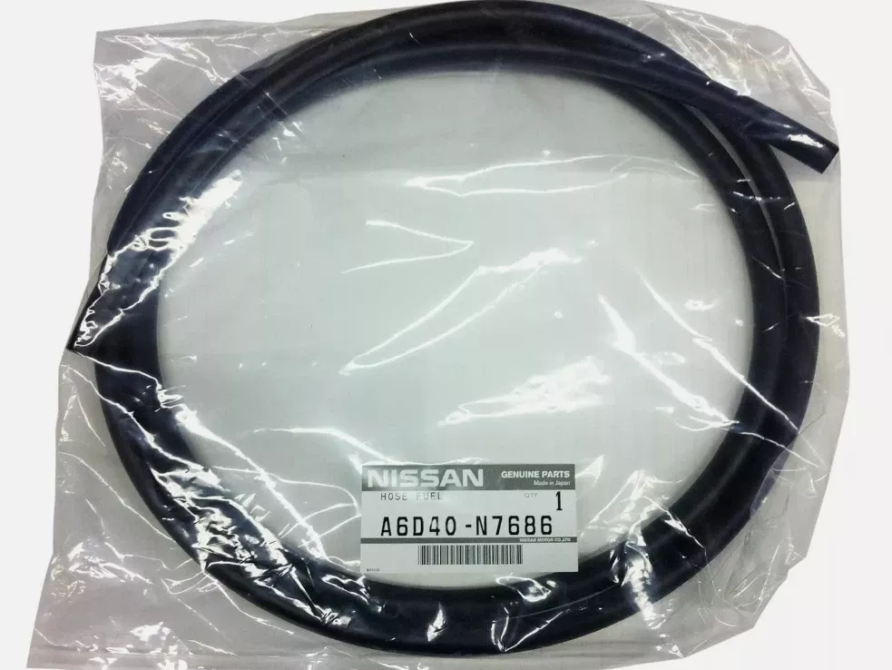

                              People say Nissan's fuel hose A6D40-N7686 is very good.
                              It should be for the price.
                              https://www.nissanpartsdeal.com/part...d40-n7686.html Click image for larger version  Name:	s-l1600.webp Views:	0 Size:	49.7 KB ID:	10152651
