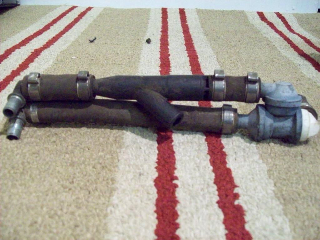

    Question about the booster vacuum line setup on my M20.
    There appears to be a connection before and after the throttle body, through a Y splitter.
    All booster systems I've had experience with only have a single line to vacuum, with a check valve.
    Why is the E30 system designed this way?

    late model has a single hose with check valve from that lower hole, like:
    I don't know why they previously used the setup you show, but in the late model cars, the top hole is not drilled through to the TB

      My late model (11/88 ) had the two lines going to the TB. I converted to the E28 check valve (I think?) so I could run the einstein57 silicone boot.
      It's very straight forward to do. The new check valve is like $30, though.

          I asked about this on my local BMW board, because I wanted to plug of that Y splitter shut to drop the idle RPMs on my old ass Jetronic m20 with shit thermostat ICV.
          The answer was different ICVs - L shape vs T shape:
          Has nothing to do with brake assistance, just allows some extra air to pass around throttle body to maintain correct idle RPMs with the corresponding ICV.
          So I plugged it shut and there was no difference whatsoever except the dropped idle RPMs like I intended.

            But at WOT the intake is at atmospheric pressure anyways. How would having access to air before and after the TB generate any more brake boost?
            Kind of like a bandaid for a poor ICV.
            Why would they go to the trouble of integrating it with the brake booster stuff though?
              Mostly. There is some pressure drop, though, enough to generate flow.
              As to a controlled leak, there's already a bypass screw to do that...

                      It's essentially a venturi pump. It takes the pressure differential between the intake hose and the intake manifold and uses it to drive what is essentially a small, weak vacuum pump as a secondary source of vacuum. It'll provide some vacuum for the brake booster when the manifold vacuum is not sufficient.
                        Venturi/ported vacuum sources are different. The angle provides vacuum as the air passes the opening when at an angle.
                        This.

                          I have no idea why they made it this way either. I tapped threads into my throttle body, plugged one hole with a grub screw, and put a 90 degree fitting in the other one with a straight through check valve to the booster. Switched to the other intake boot without the extra hole. No ill effects. No noticeable change, other than fixing the vacuum leaks from all the old cracked rubber and plastic bits I junked. Mine's an '89 iX, so I'm not sure it's a early/late model thing.
