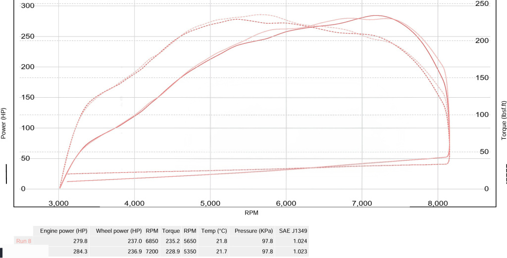

Name:	Screenshot_20251212_174115_Adobe Acrobat(1).jpg

ID:	10152911 Good Morning everyone,
                        I would to share with you our Frankenstein M20 that we finally dynoed 1 week ago
                        It's diesel block, 885 hand ported head,Dbilas open M5 3.6 itbs with their trumpets, 3.0 crank knife edge and balanced and 84mm pistons on 140mm rods, electric water pump and fan, mechanical pump deleted. Standalone ecu tuned by me.
                        • 2mAn
                          Señior Mod
                          • 20566
                          #162
                          Those are some impressive numbers!! What’s the compression ratio on your setup
                          Simon

                            #163
                            I'm not sure, we are using stock parts from other engines, nothing is forged. The static compression is around 180 but our giant retarded camshaft is lowering the numbers

                              Those are some of the highest m20 numbers I have seen. I want to know every detail of this motor! I've never heard of an m20 diesel block before or anyone using 140mm rods in an m20.
                                Trying to break this down a little more with my failed ME math
                                84mm Bore X 85.8mm stroke = 2853cc or a solid 2.9L
                                Compression Ratio is still a mystery because US S50 had 135mm rods, EU S50 had 142mm…
                                What fuel does the motor like?
