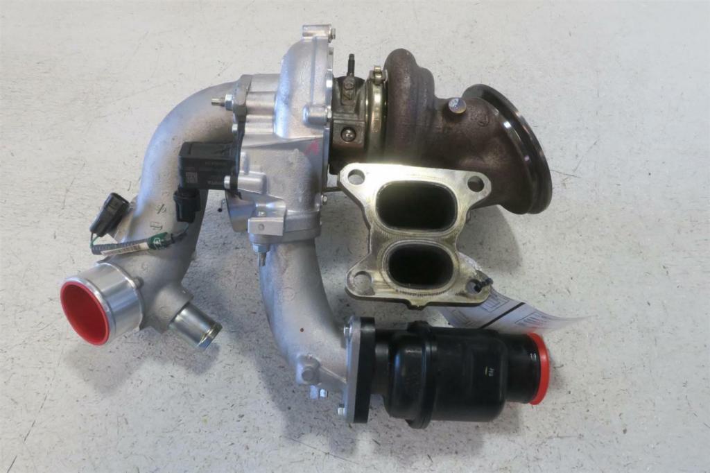

                                #135
                                Toyota appears to be twin scroll, they just don't advertise it like BMW. https://www.ebay.com/itm/133654648734: Click image for larger version
                                Next time you’re behind a modern BMW turbo car at a stoplight, take a look into the exhaust tips. Often if they have the OEM exhaust cutout/bypass valves, they’re built into muffler outlet. When the driver pulls away from the light at presumably low to medium pedal, you might see the butterfly valve open briefly. Presumably to reduce backpressure to get the turbo to spool faster.
                                The flapper has been around since the e36 ;) I opened my shop about the same time e46's ended, so got familiar with them and vacuum leaks straight away. Then started the m54 oil pan gaskets, then, then lol. Still rocking e30's, though. We don't work on much of anything after e46, none after e9x.
                                That little flapper isn't going to change how quickly the turbo spools, however, with a twin scroll system, there's two ways you can go about spool time.
                                One is to use the twin scrolls the "old fashioned" way, and pump half your cylinders into each division in the turbine - it appears this is what Toyota did.
                                Two is to have a control valve on one side of the turbine, but the whole engine feeds the whole inlet. Then in early RPM's, the valve can be closed forcing the entire engine through one division on the turbine. This gets the wheel spinning very quickly, but will also choke the engine prematurely, so as RPM increases, you open the valve until the whole turbine is receiving all the exhaust gasses.
                                I am not familiar with the inner workings of the n20 manifold, but from the outside it appears it may be the latter.
                                When I started putting turbos on non-turbo cars many years ago, we would just get whatever turbo we could get our hands on. Many big turbos from diesel tractors work well, but the exhaust sides are huge. Many would just block half the turbine, but then people started playing around and using waste gates and utilizing the second half of the turbine. I seem to remember a company making a t4 "quick spool valve" with a flapper door, but they weren't reliable from what I recall.
                                EDIT:
                                The Ultimate Quick Spool Valve for Turbocharger Test with dyno sheets, data, back to back runs, and tuning of the boost response on engine and motor.
                                and
