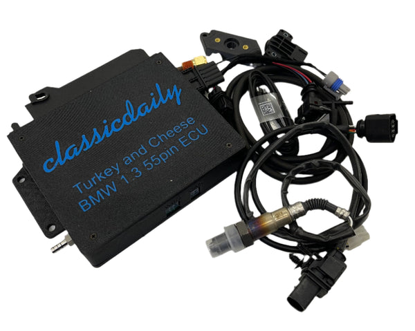

                          Originally posted by AWDBOB
                          I would recommend going this route over MS. Supporting a small business in the community with great features at the price point.
                          https://www.classicdaily.net/product...g-and-play-ecu
                          This is the route that I went. Jake is the best. Great customer service
                          88' Seta 2.7i Zinno

                            OP just in case it wasn't clear, a Plug-and-play ECU will still need to be tuned either by you or a someone else.
                            They can come with a base map, but it will need to be dialed in by someone who knows what they're doing.
