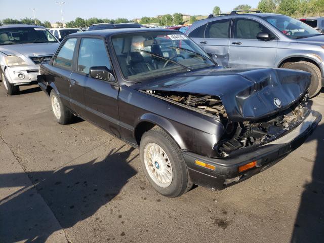

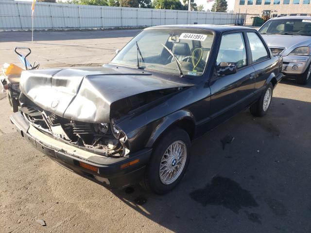

    hello new blood here, I bought a alpine white 318is last year but ended up selling it due to the vehicle stalling out every time I took it out, spent time fixing vacuum leaks, swapped in a new gas tank, fuel pump and idle control, pcv and etc but ended up letting it go. I've been lurking on the around for awhile for another one and found one at a auction lot, i've provided pics below. estimated value is 800 and is located in denver but i live in queens ny. title is salvage and has 142k on the clock. question is should i bite the bullet or no. thanks for looking.

      Without seeing the chassis rails who knows. However, the value is probably there after shipping/fees. So it just comes down to your desire to do work or pay someone else to do it, and in that case the value is questionable.

        If the frame rails are compromised, I would not even think about taking it.

          looks like a great one to fix

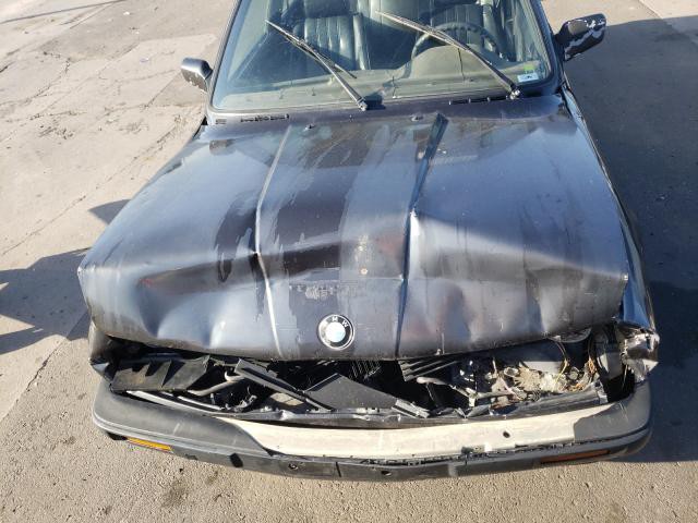

            it's actually not a hard fix. core support, fenders, and a hood. Plus all the broken plastic stuff. But it's definitely a bit of a project. I'm not sure it would be worth paying a shop, but DIY, sure.
            It missed the frame so there's unlikely any structural damage.

              No way I'd touch that for $800 plus another $1000-$1500 in shipping. Maybe if you were local, but that's a lot of cash for a salvage title non-driving project, especially because you can't inspect it to know the extent of the damage.

                Rust is the big question. Do you want to deal with it if its there?
                Looks like the rear subframe / trailing arm is tweaked also. Who knows the extent of the damage. I would only go if you're ok with it being a parts car in the end.

                        I personally don't like the look of the back edge of the passenger's fender.
                        Sometin' might be wonky there.
                        Vs driver's side, where it's not showing signs of movement.
                        If that were on C-List for $500 locally, sure.
                        But you do know that if the motor was what stopped further submarining,
                        then the trans and diff may be toaster strudel.
                        I say leave it to someone locally.
