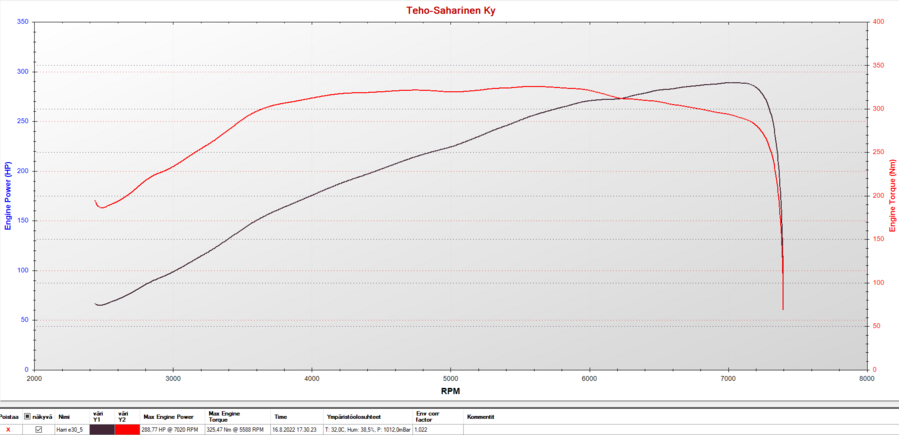

            Did I read this is making close to 300 crank hp?
            • hasa
              • May 2013
              • 307
              Dyno reading was 288bhp/7060rpm. Faster than M50B25 but slower than S54B32, that's all I know for sure!

                      But how are you going to talk about and show the worked-over engine without dyno graphs!?!?!! Also, what's the tube that crosses over the engine to the passenger front?

                              Originally posted by McGyver
                              Awesome car and really nice build!
                              I just watched the video, that thing is QUICK!!!!
                              Thanks! That crossing hose belongs to the ghetto tuned breather system.
                              Dyno graphs were originally published in the build thread. As there are always discussions of error marginals and different measurement standards, I did not publish them here. But here it is.
                              Gearbox is a 4-speed dogbox made in Finland. New 5 or 6 speed would be great, but costs arm and leg. The bellhousing is sourced from U.S. Some friendly guy from this forum helped me years ago to get a special M20/Getrag265 housing that is never sold in Europe. Many don't even know that one exists.
