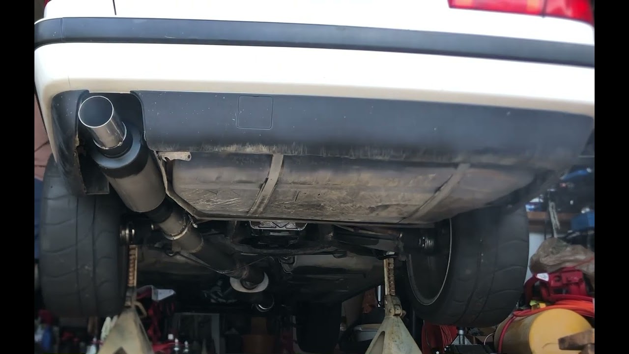

    • 3.5" twin muffler turbo back exhaust with stainless downpipe and wastegate tube

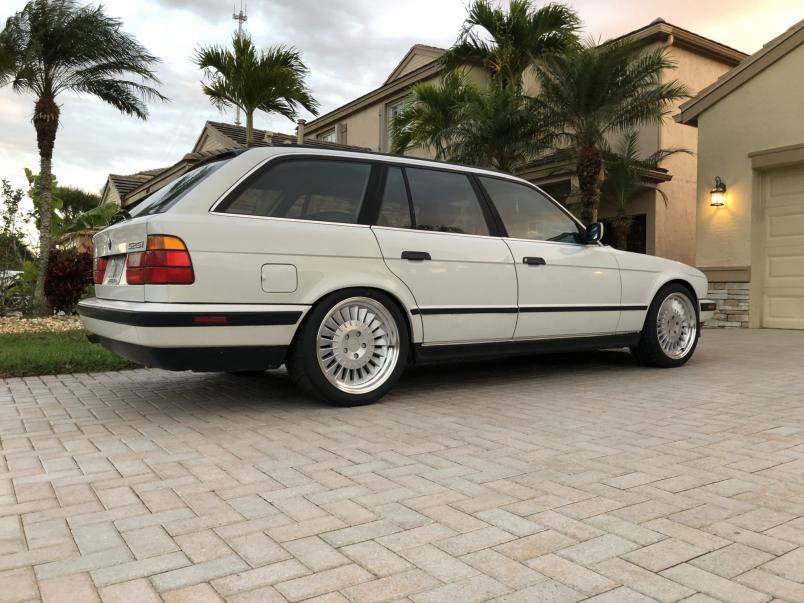

                            Good news first. I finally got tires on the new wheels and mounted them. I was not sure about them, it was a toss-up between too busy for a simple car and really different and cool, and I'm pretty happy with the result and my offset math was dead on. The fit is close to perfect, I used the 20mm spacers the car came with, maybe if they were 18mm it would have been a little better up front but so far there is no rubbing.
                            18x8.5 ET35 front with 20mm spacer, 245/40R18 Extremecontact Sport
                            18.9.5 ET40 rear with 15mm spacer, 275/35R18 NT01
                            I couldn't decide what tires I wanted, A052s or ZIIIs, availability for both was spotty. My tire guy recommended going with NT01s as a suitable tire for trying to put my power goal to the ground, with a solid streetable tire in the front which will handle rain better. I went with it. I realize that putting a 100 treadwear tire on this car right now is putting the cart before the horse, but the old tires were shot, dangerously shot, so it was time for new rubber and to get these wheels. More motivation to get the engine together and in as soon as possible.
