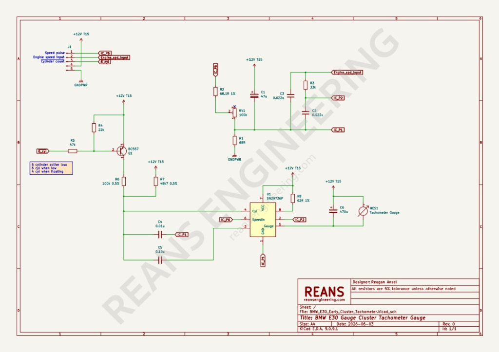

                  I'm picking up a friend's used cowcatcher for 250 bucks including fog lamps but I have instructions on how to install it thanks to one bmw service notice that is pinned on my wall lol, However I do know a guy who works on these clusters so here's a image pulled from his website. Credit goes to Reagen Anills.

                  I believe you can message him on facebook if you wish regarding questions about your gauge cluster.

                    funny that you ask about the tach, i just looked at this thread:
                    Any interest in e30 cluster gauges testing info (speedo/tach/fuel/temp) - R3VLimited Forums
                    buy a cheap signal generator from amazon and go to town. my bet is a broken solder joint (touch it with a soldering iron to reflow) or a broken wire/plug on the diff.

                      Hey, I see my schematic is posted here. I don't have a facebook page for Reans yet but you can find my personal account under Reagan Ansel (the name on the schematic). If you have more specifics about how your tach doesn't work and what kind it is I can help troubleshoot.
                        I checked the fuses and they are good. The rest of the Cluster works so not sure its the SI Batteries... possible bad connection. At one point is was a little intermittent, then its just stopped completely.
