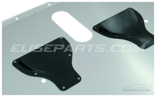

                              After some thought I am leaning toward starting with something like this on the underside of the car to start. The plan would be to make a large scoop to pipe air up to the turbo. I had plans to build a custom undertray from ABS plastic anyway. With more air coming in from underneath it would still have to escape somewhere. Reading more about this and watching wind tunnel videos apparently its all about reducing positive air pressure in the engine bay. With no way to release air from the top, louvers in the hood seem to be the only real option that works...
                              Click image for larger version  Name:	image.png Views:	0 Size:	138.7 KB ID:	10143121
                              ​Condor has a louvers. Paint matched and properly installed it may look ok. Still on the fence.

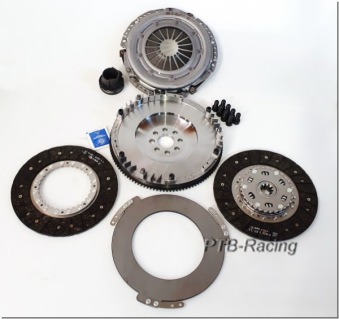

                              On another note the ClutchMasters FX350 clutch and flywheel I purchased for the car at the beginning of this whole ordeal now may not hold the power levels of my engine.
                              We had a client bring in a m52b28 top mounted turbo E36 drift car for a vanos rebuild. The engine is making 870whp on E85 @ 31 psi and 580 whp​ on 91 @ 22psi. Absolutely insane. The ZF 320 is holding it no problem. Out of control.
                              Here's the kicker. The car has some serious cooling issues LOL. Just goes to show that a 50k budget track car done considerably well (with 3 hood louvers)
                              STILL has engine bay overheating, AC system suffers and the whole right side of the bay is completely cooked.
                              Anyway,
                              This is the twin disk clutch that is installed. Pretty wild and very street use friendly.
                              This may be my next purchase as things progress.
