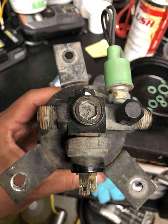

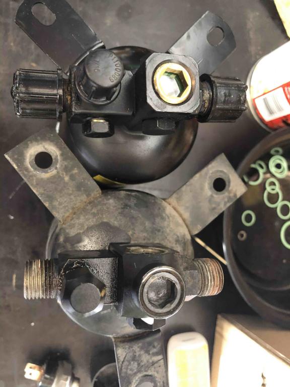

                          Thank you to glucklich21 for the original write up and Jeffinhiscars and everyone for the updates.
                          I have an 84 ETA. When I bought my car 2.5 years ago the A/C wasn’t cold. I took it to an A/C repair, and they changed the fittings and filled the car up with R134. They A/C was cold for about 9 months and then it started to get warm again. I usually had the system recharged every 9 months. The last time I had it recharged they put dye in the system to find the leak and it got warm after less than 6 months. When I took it in, they could not find a leak anywhere. We didn’t look at the evaporator and they said the leak could be there.
                          I was initially going to just change the O-rings and dryer however my good friend Victell had an extra evaporator and John (ForcedFireBird) gave me some expert advice. I said what the hell I might as well do everything while the system is evacuated. I put in a new evaporator, R134A expansion valve, parallel flow condenser and flushed the lines. I’m in Hawaii and it’s usually 75-85 degrees and rarely breaks 90 so I decided not to go with a Spal fan.
                          I bought a new pressure switch for the dryer however I was wondering if I could use my original low and high pressure switches. The new switch valve pin doesn't seem long enough, and I would prefer to not have to cut/splice any wiring.

                          • cory58
                            • 1021
                            #628
                            Yes - you can use your existing pressure switch set-up, but there are different dryers for 1 vs. 2 switches. I kept 2 switches when I upgraded my system, but had to reorder the correct dryer. I can find the Bosch part number if needed.

                              #629
                              Cory
                              Thank you Cory!
                              The new one looks exactly like my old one but the PN on my old one is worn off. I bought the Mahle AD 240000S which shows up as PN 351200091 and 64531466051. If you could share your part number that would be awesome!

                              • cory58
                                • 1021
                                #630
                                Thank you Cory!
                                Sorry - I meant Mahle/Behr, not Bosch. I think you have the right dryer for the 2-switch set up. Here are the part numbers I have.
                                On box - AD240000S
                                On dryer - 50986A
