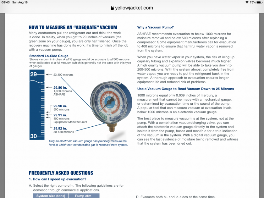

ID:	10022026 I get asked often enough about AC that I wanted to share this. It explains rather clearly why using a manifold gauge to figure out when you've pulled a proper vac is an exercise in futility. The difference between 500-1000-1500 microns is a hairs width on the dial.

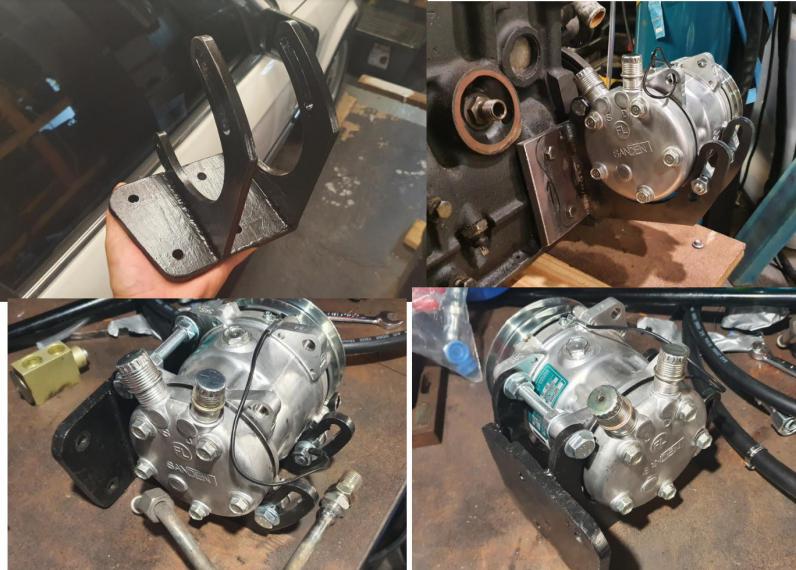

                    Thought some of you might be interested in the compressor that i put on my m20b23. I couldn't find an oem r134a compressor in Australia for less than about $1600 aud....
                    So I used a Sanden SD5H09 gineric R134a compressor, that only cost me about $330 AUD brand new. You can get them with the V belt or the ribbed belt, obviously get the V belt one. probably even cheaper in the USA.
                    I made my own bracket as the oem compressor has a really long nose on it and the Sanden is significantly smaller than oem. In heinsight i should have made the bracket so the compressor sits slightly lower as it does make the CAS very hard to remove (i have an m20b25 CAS - megasquirt)
                    I then had to modify the hard lines - you can see where i TIG welded on a new fittings to the hard lines (after cutting off the rubber bit) - these were called "bulk head connectors" for AC lines. Then just got some hose and fittings and made new lines to suit - these from were a vintage AC shop - really quite cheap and easy to make - supplied with a crimping tool. excuse my welding - first tig project - but it doesn't leak!
                    The rest of the r134a conversion was same as specified, i did just re-use the r12 condensor. seems to work fine. New TX valve and dryer were pretty cheap and then I just put new R134a orings everywhere. got it gassed a month or two ago, and works quite good and the sanden is very quiet, hardly tell its on.
                    I have since put a bit of heat protection on that AC rubber line - but its not as close to the exhaust as it looks in the photo.
                    Apologies for the photos uploaded weird.
                    Click image for larger version  Name:	compressor.jpg Views:	0 Size:	78.6 KB ID:	10022276
                    Click image for larger version  Name:	AC 2.jpg Views:	0 Size:	67.6 KB ID:	10022277
                      Nice!
                      You have the stock oil cooler I assume?
                      E30 320i vert
                      But daily drive is Volvo V60 Polestar
                      • e30davie
                        • Apr 2016
                        • 1788
                        #641
                        I don't have any oil cooler. I don't think any of the M20b23 had an engine oil cooler. Mine was originally auto, dunno if the manual one did.

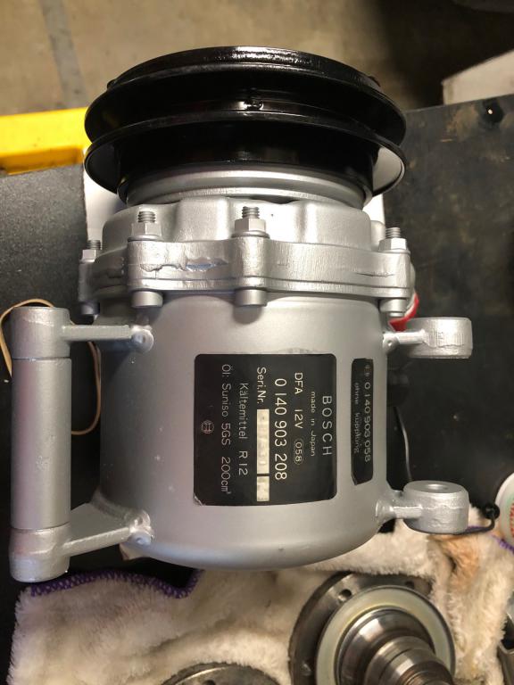

                          Since I had was replacing everything with new parts I decided to sent my A/C compressor out to be rebuild. It was working fine however I didn't want to have a weak link in the system and have to go in there again. Mike from Discount A/C was very informative and rebuilt it in 1 day. Shipping wasn't bad either as it fit in a USPS medium flat rate box. Total cost was $172 including shipping, insurance and pulley bearing replacement. They also have good prices on new and rebuilt A/C
                          http://www.discountautoac-compressor...or-C20804.aspx
                          Click image for larger version  Name:	Dirty Compressor.jpg Views:	0 Size:	54.2 KB ID:	10022574 Click image for larger version  Name:	Rebuilt Compressor .jpg Views:	0 Size:	54.0 KB ID:	10022573
