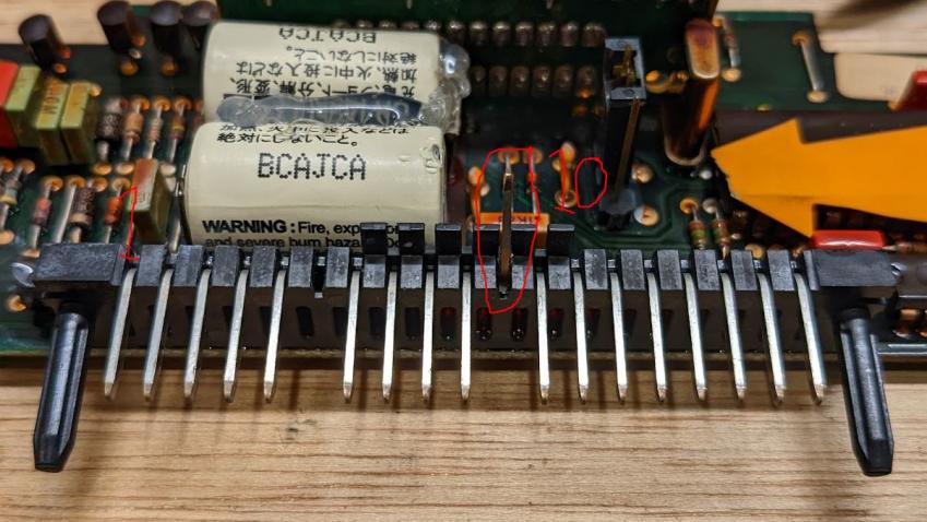

                  And BOOM! Done!!! All you need to do is bend the vehicle speed signal pin from the SI board out of the way so that it no longer sees the VSS pulse, and then bridge the fuel rate input to the VSS input on the SI board. Now, the SI board will see the SAME pulse for both inputs, and you can drive the whole gauge based on providing this custom 12v pulse via the fuel rate pin. So here goes:
                  Firstly, the schematic of what we're doing, for reference:
                  Click image for larger version  Name:	Econo_schem.jpg Views:	0 Size:	65.9 KB ID:	10053073
                  Step 1, bend vss input pin on the SI board back out of the way. Bend rather than cut so the process is reversible. On my SI board it's pin 10 (1 is on the far right if you're looking at the cluster, left in the pic):
                  Click image for larger version  Name:	Econo_bend_10.jpg Views:	0 Size:	72.2 KB ID:	10053077
                  Step 2, bridge the fuel rate input pin (9) to the VSS pin (10) on the bottom side of the SI board:
                  Click image for larger version  Name:	Econo_9_10_bridge.jpg Views:	0 Size:	72.4 KB ID:	10053072
                  Step 3, Make SURE that the signal you're providing is a 12v square-wave. Use a pull-up resistor (1k~10k ohms) to +12v if you need (my Megasquirt 2 needed this, a 5-volt square wave won't work). Then just connect this to Pin 11 on the white connector (yellow/white wire at the cluster, white/black wire from the ECU connector), and program your duty cycle accordingly! I tested this using the Fidle output from my test MS2 (easy to test this way by adjusting CLT on the stimulator), set to a frequency of 124hz. My results of gauge position (MPG) vs duty cycle are attached, both 'normal' and 'inverted' are included depending which way your signal goes:
                  Click image for larger version  Name:	Econo_Duty.jpg Views:	0 Size:	34.7 KB ID:	10053074
                  Final note, remember that the Econometer gauge will NOT work until there's an RPM signal; aka it won't do anything with key-on-engine-off. Engine needs to be running before it 'comes alive,' even though RPM has no influence on the reading. The final pic for proof!
                  Click image for larger version  Name:	Running!.jpg Views:	0 Size:	71.0 KB ID:	10053075

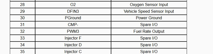

                              Just want to revisit this topic real quick. MSPro M20 PNP has assigned the output for the fuel economy gauge. Since it's PNP and no mentioning about bending any pins, does it actually work with this this PNP MSPro setup?
Name:	Screenshot 2024-11-04 164918.jpg
                              • Austrianvespaguy
                                • Aug 2018
                                • 88
                                The PNP works without modification if you JUST want the gauge to display the (approximate) MGP, like stock. If you want it to show 'something else' then you need to hijack BOTH pins. Reason is in the factory setup, the SI board does a calculation based on TWO inputs, fuel rate and vehicle speed, and then drives the gauge accordingly. PNP PWM3 output goes to the fuel rate input just like factory. But if you send out say AFR on PWM3, the factory cluster will STILL drive the gauge based on its internal calculation of AFR x Vehicle Speed, which is obviously a nonsense value.
