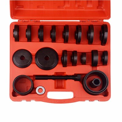

              Can this tool be used?
              23 pcs Front Wheel Drive Bearing Removal Press Adapter Puller Pulley Tool Kit
              • twright
                • 707
                Probably not. The big problem with the subframe bushings is the length. You have to have a receiving cup that is long enough to push the busing all the way out of the subframe. If the receiver isn't long enough, the bushing only comes out part way.

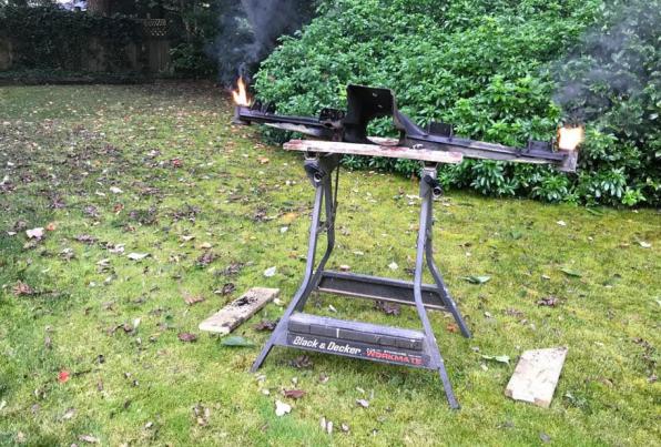

ID:	9966705 I found burning them off to be very easy. To get the metal shells off...i used a sawzall to carefully cut a slit, then it just pried off very easily.
                    I tried using a bottle jack at first to push the bushing out...it just bulged out like almost half way but wouldn't budge...like glued in there. The burn method worked great. To get the new ones in; i used the bottle jack, a little soapy water and a touch of heat
