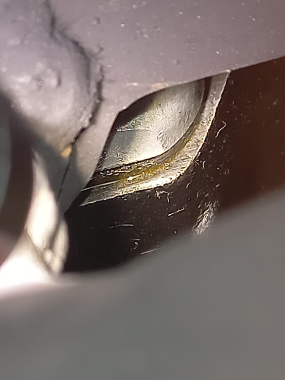

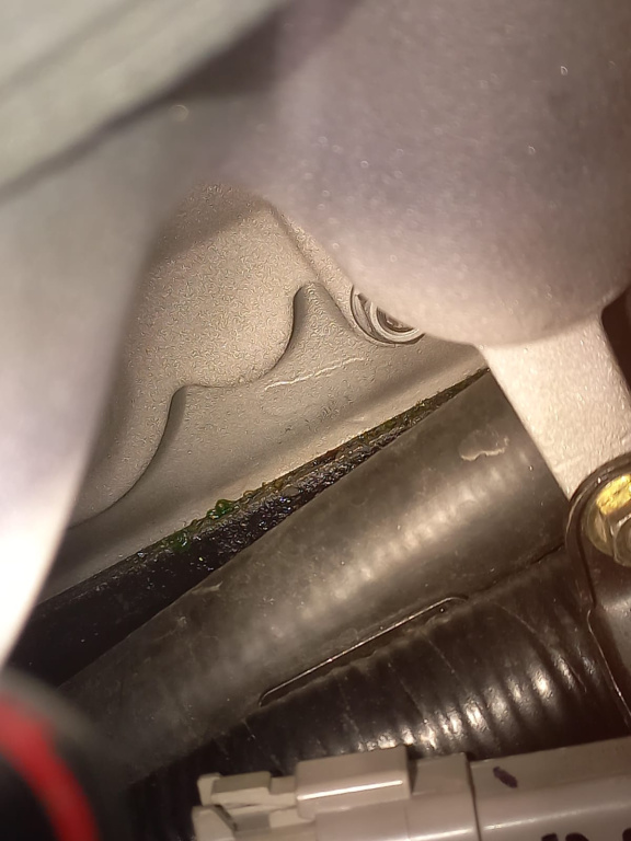

    I used an Athena Cut-ring head gasket on my high hp turbo stroker. Block was obviously machined, as was the head. ARP studs using ARPs torque recommendation.
    1 hour on the dyno @ 6psi loading it up for run-in and this has happened.
    The entire way round this gasket is leaking, its pushing through the composite. Oil on the exhaust side and coolant on the intake side. All the way along the length of the block.
    The sump has coolant in it as well, lots of green through it.
    Initially I had seen reports of these gaskets having issues with leaking coolant from the get go and kind of hoped if I had followed all the correct processes and torque procedure
    I would be ok. Nope.
    So now I have to strip off the head and get it re-machined as there are now rings embossed in my head for no reason. How is it a 30 dollar Elring gasket will seal on a surface I prepped in my garage for years but yet this gasket cant seal on a machine prepped surface. Thats terrible and ultimately could of cost me an entire engine if this went unnoticed during the run-in procedure. Do not buy an Athena Cut-Ring headgasket for your M20.
    Here's the best bit. Athena have clauses that release them from providing any warranty what-so-ever.

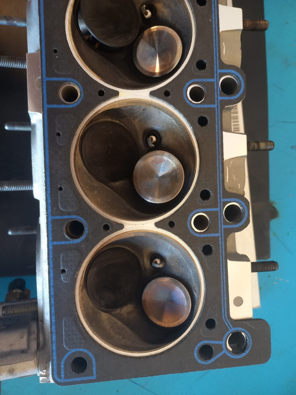

                So following up on this after removing the head this morning.
                - No coolant in bores
                - No oil in coolant system
                - Lots of coolant through oil system
                - Cylinder pressures were sealed by the cutrings
                Head will need resurfacing due to the grooves cut by the stainless rings
                this surprised me. I now have a small groove i need to level off the deck of the block. Its only really happened on one cylinder. Bit of a pissoff tbh.

                The headgasket looks unmarked, no evidence of trouble spots.
