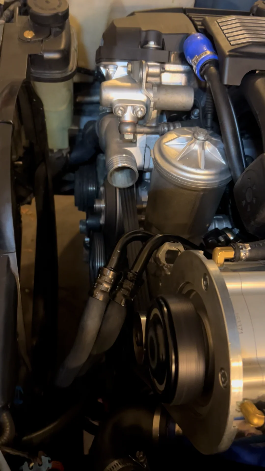

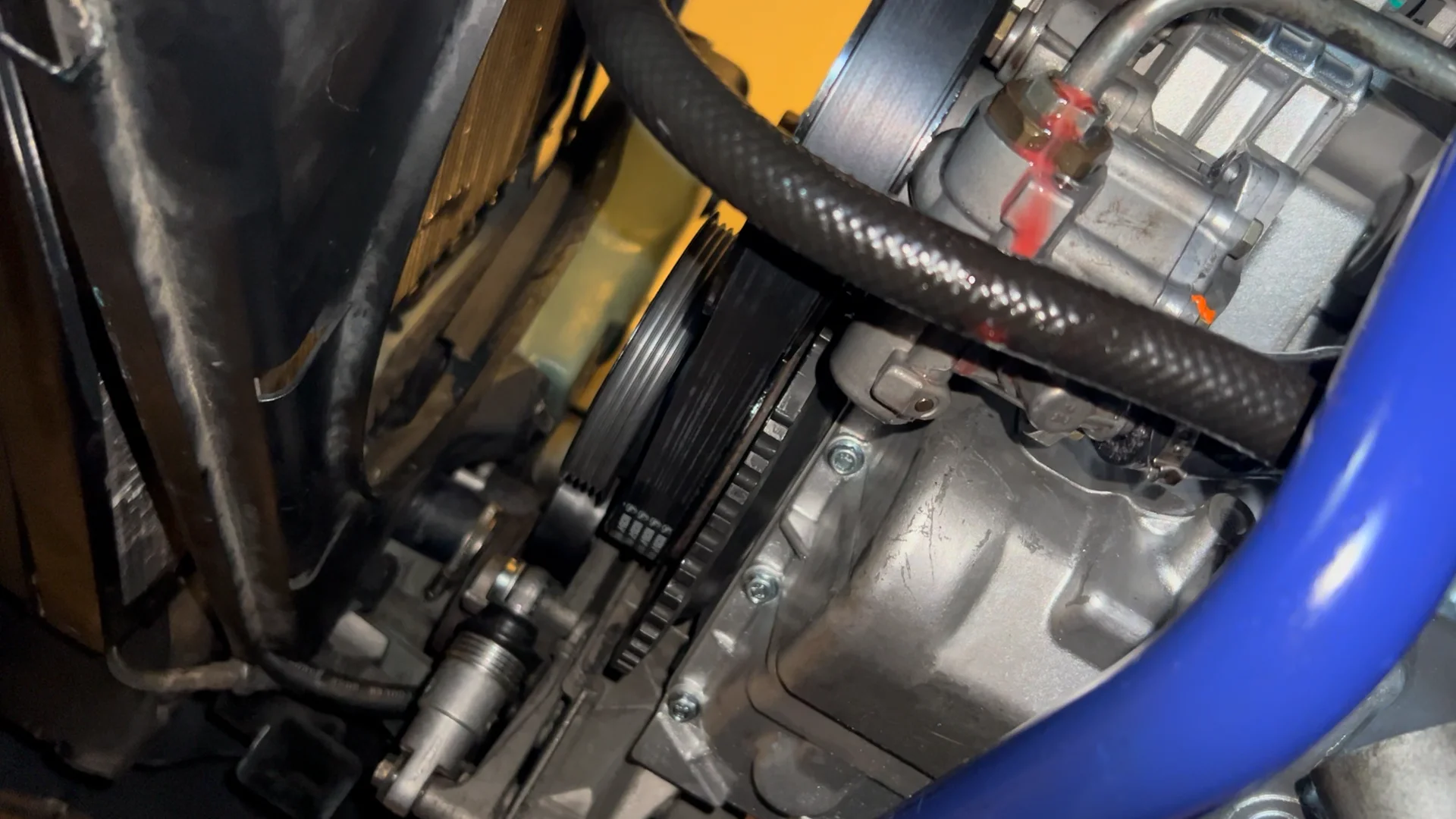

          Been wrestling the belt for 2 days.

                  All pulleys are stock, bigger belt is due to the supercharger.
                  So, thanks to the difference in the S54 oil cooler housing & M52, the power steering pump mount is different & the alignment is off so the belts don't run properly.
                  I ordered an S54 power steering pump
                  Pry bar to the radiator trying to get the belt on is no fun.

                    #234
                    what exactly is that bungee doing there
                    cars beep boop
                    • parkerbink
                      • Jun 2004
                      • 10138
                      #235
                      Holding the ratchet that is on the tensioner.
