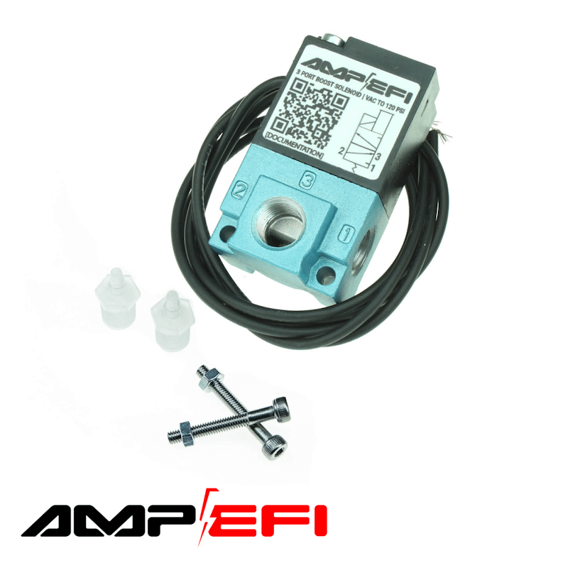

            Ever thought about getting an ebc to smooth out that massive drop at the end?
            You have MS. It should be about 50bux installed.
            1 of the best mods you can do for real.

              I think of it every day lol, increasing boost near redline would make a pretty sweet power curve. when I had a small hole in the wastegate vacuum line it did the same thing and resulted in zero power drop off near redline.

                  I'll see how the car runs with the newer turbo before I get into any electronic boost controllers. Basically all I would use an EBC for is to gain boost by redline to flatten out the torque curve which I believe MS can do if you set it up for it.

                    The $50 MS one does the same stuff the apexi does, but it's $50 :)

                      exactly, I would never spend that much on a boost controller.
                      care to share exactly how to set it up on megasquirt. I'm not sure where to start but I also believe it needs a variable TPS correct?

                        You don't need tps.
                        But if it's not setup that's a stupid ez fix that you should do.
                        $50
                        $8 or buy the parts locally.
                        How you run vacuum lines.
                        http://www.boostedmiata.com/MS/msebcwiring.jpg
                        How you wire it in.
                        This is what mine looks like.
                        Tuning is just as easy.

                          I believe whodwho already has mine setup for the boost control internally when he setup up my launch control and wasted spark setup. so all I have to do is run wires but I lost the diagram for which does which on my DB15 connector on the unit, If I could find that it should be easy enough to setup.
