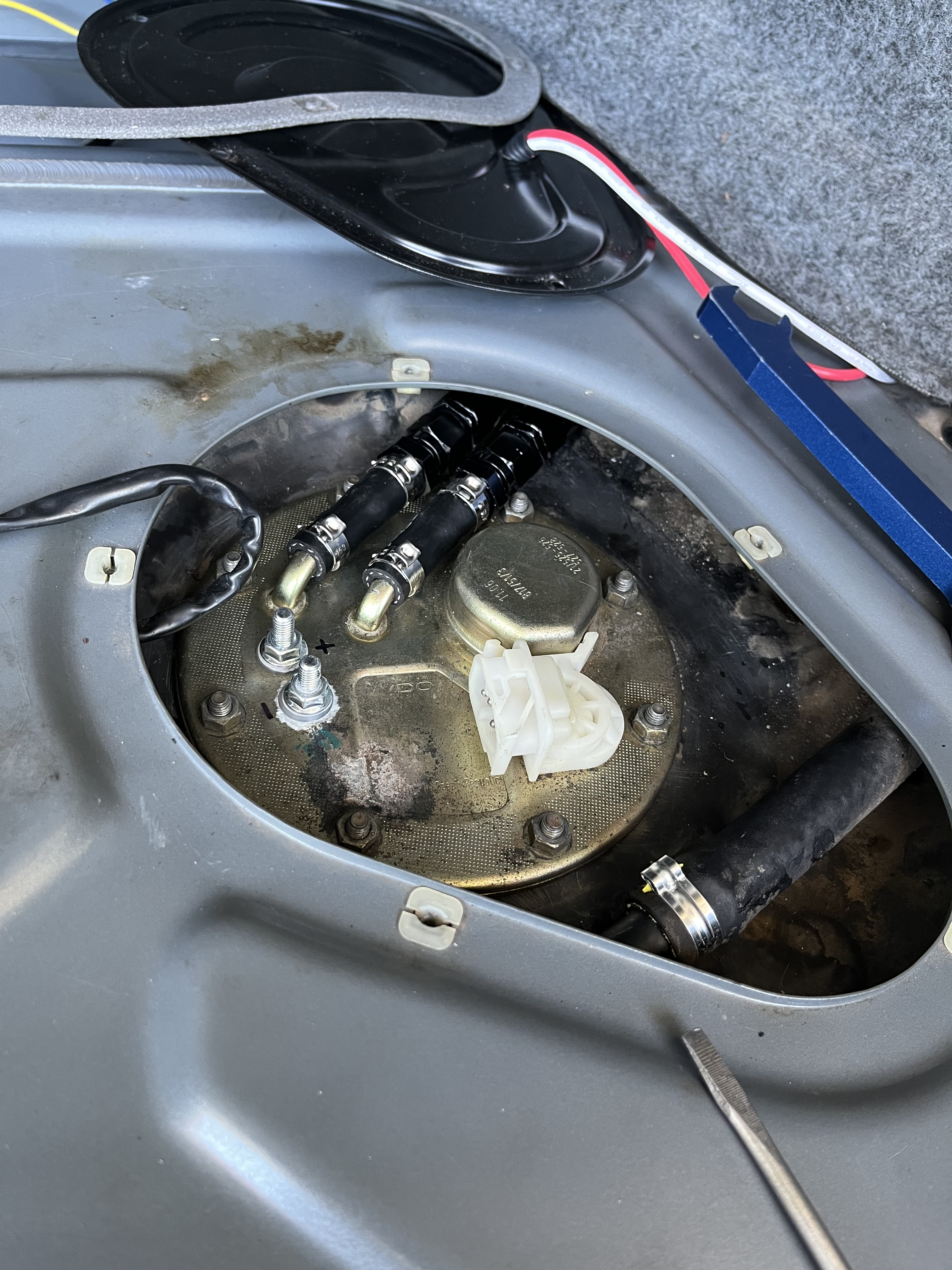

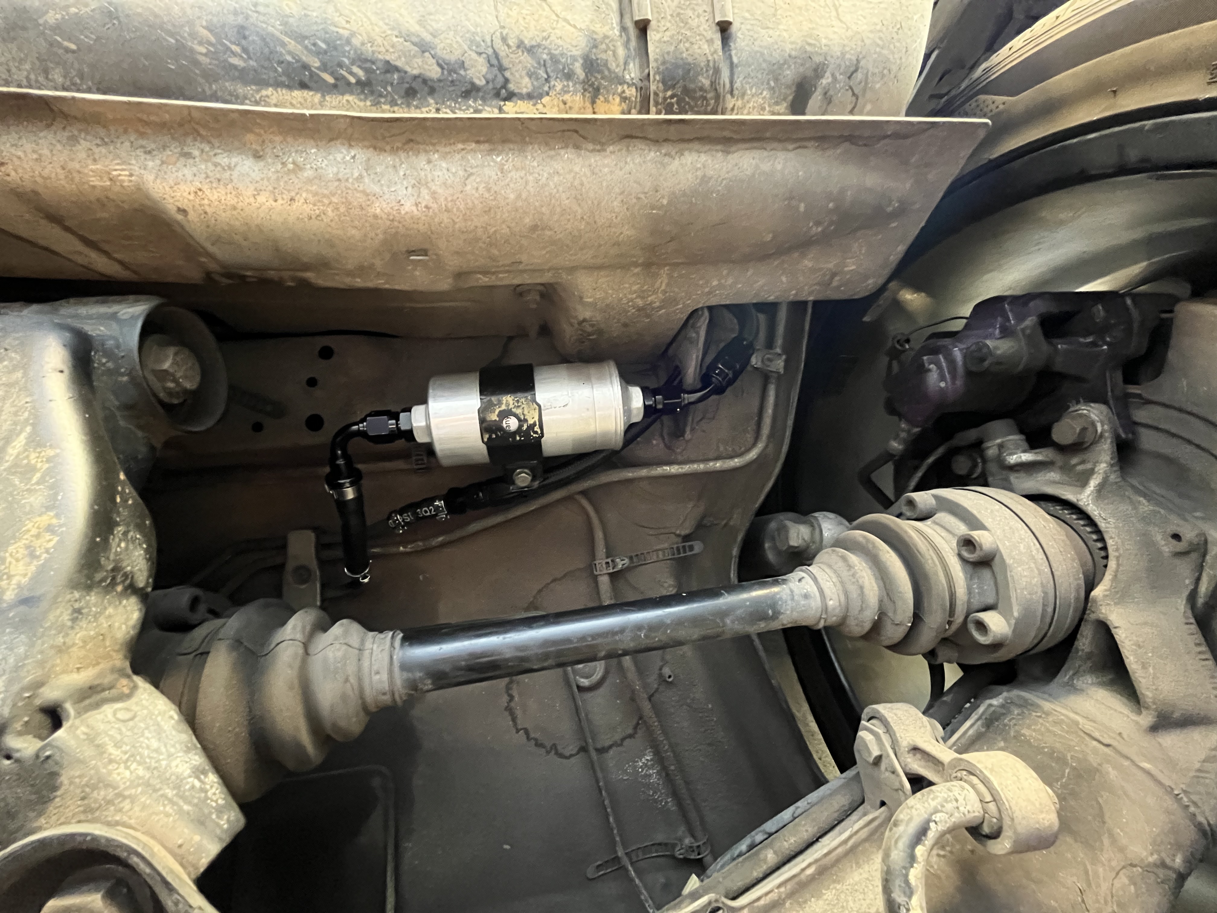

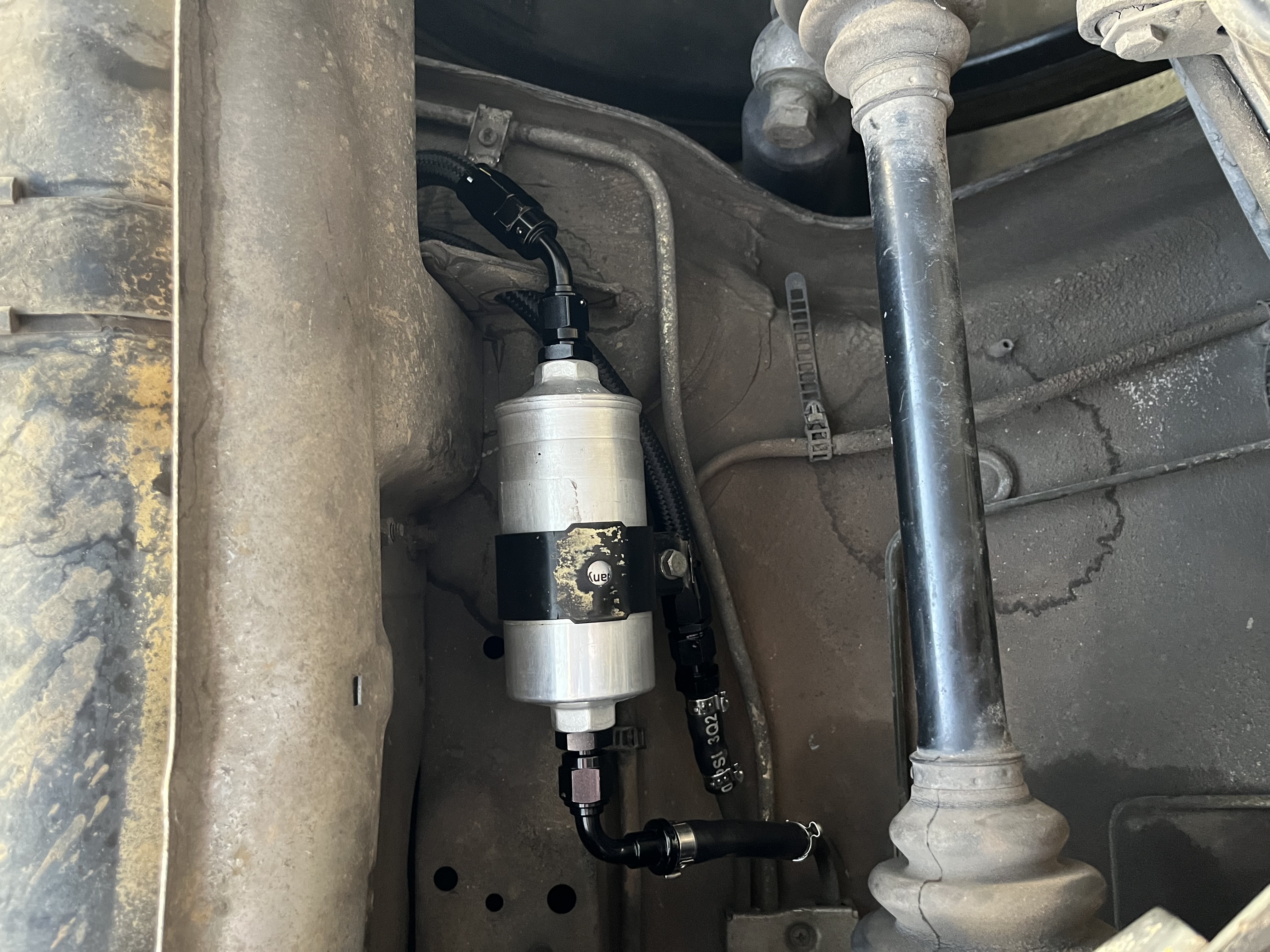

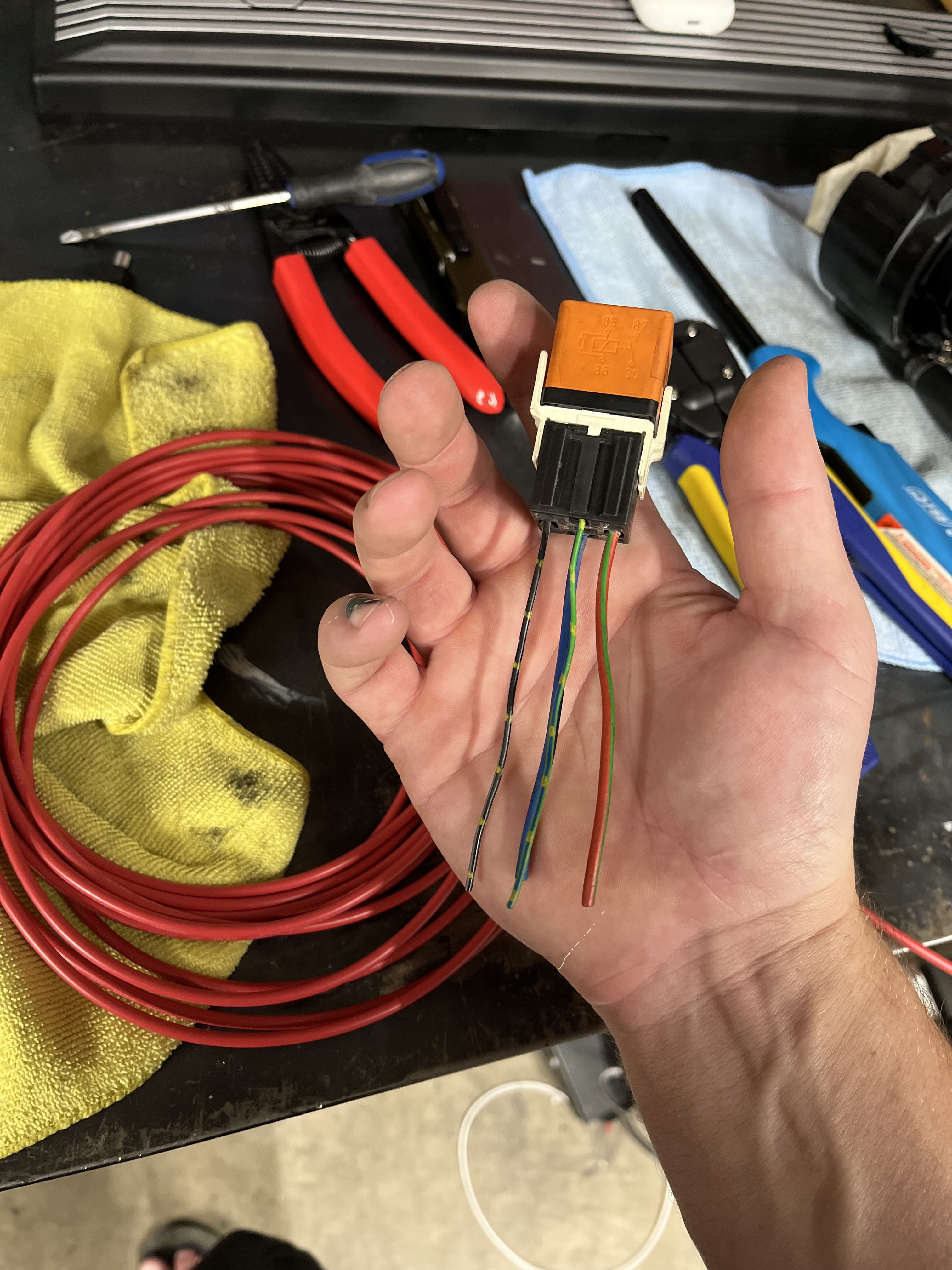

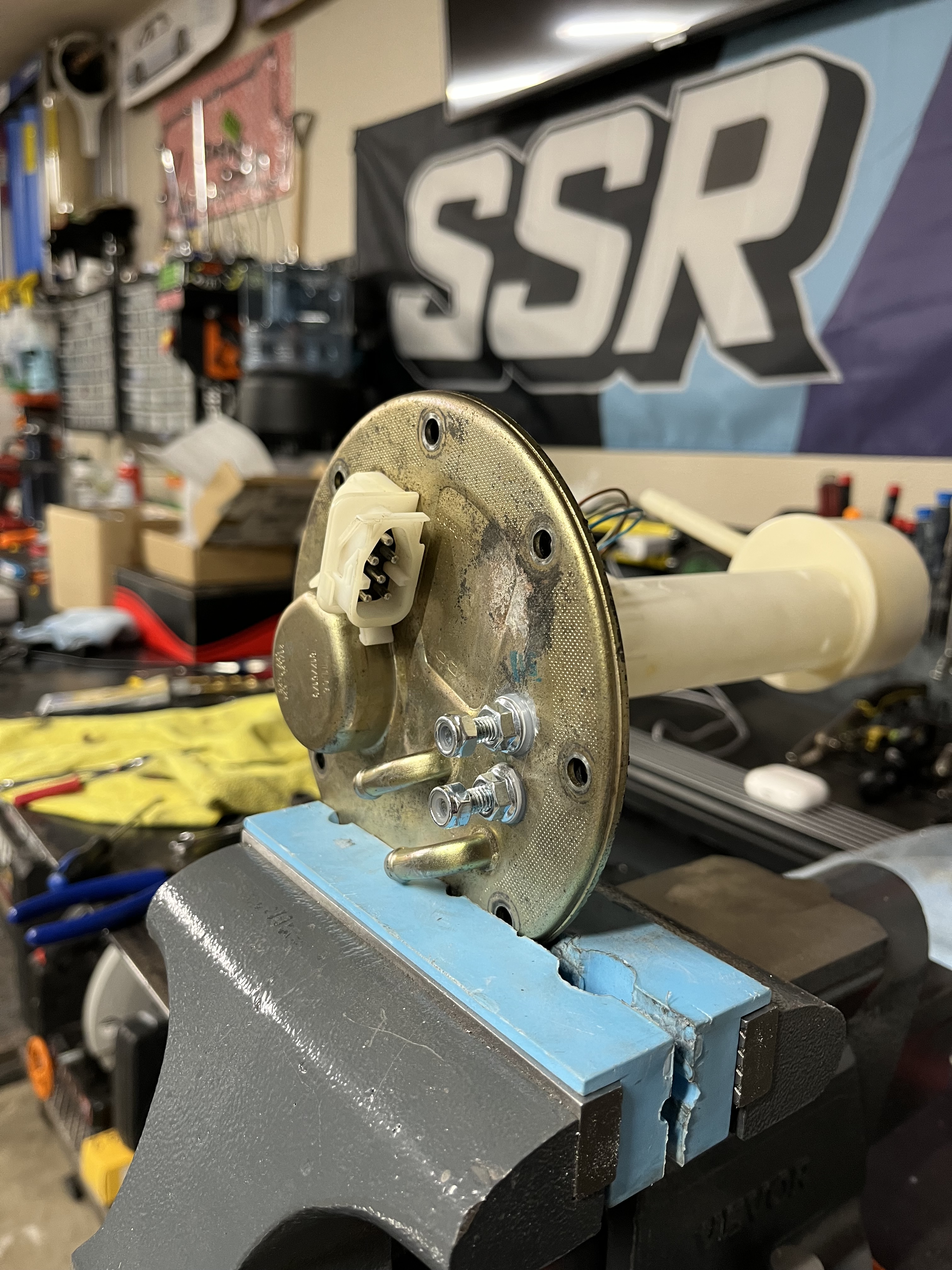

    More tuning and some lovely time plots revealed that I have a pretty serious fuel pressure drop under boost. System is a 255lph, stock lines stock rail (now with 870cc injectors) Green giants have been replaced as they are too small for my goals. I later installed a 340lph and still the same results
    With a 10-15psi drop in fuel pressure it was clear the stock wiring was overheating. I made my own bulk head and upgraded the wiring. While I was in there I installed a 400lph pump and converted the fuel lines to -6AN. Stock fuel filter went in the trash. Modified the factory hanger to mount a Porsche threaded filter with fittings. I hard wired in a relay to control the pump and pulled power directly from the battery.
    Here are a few pictures. A simple OEM relay does the job perfectly.
    With the pump and lines sorted I could now move on to other problems I ran into. Including dyno rolling we have about 1500 miles or so driven.

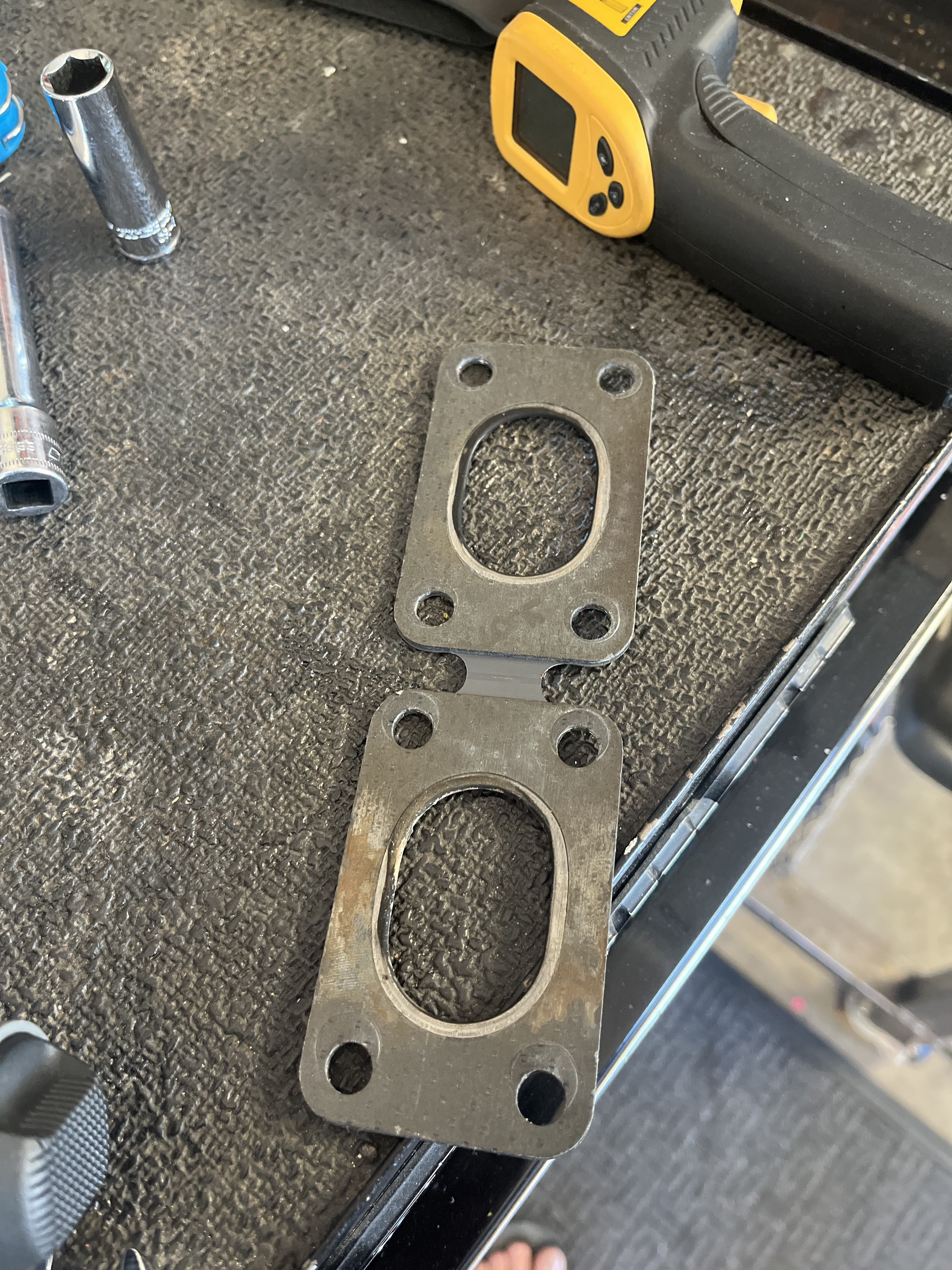

    Exhaust leak the header developed on cylinder 1 and the engine sounded like a tractor.
    To get to it is a major ordeal so yet again the car is back in the air with the exhaust and turbo completely torn down.
    Here you can see where the gasket has failed.

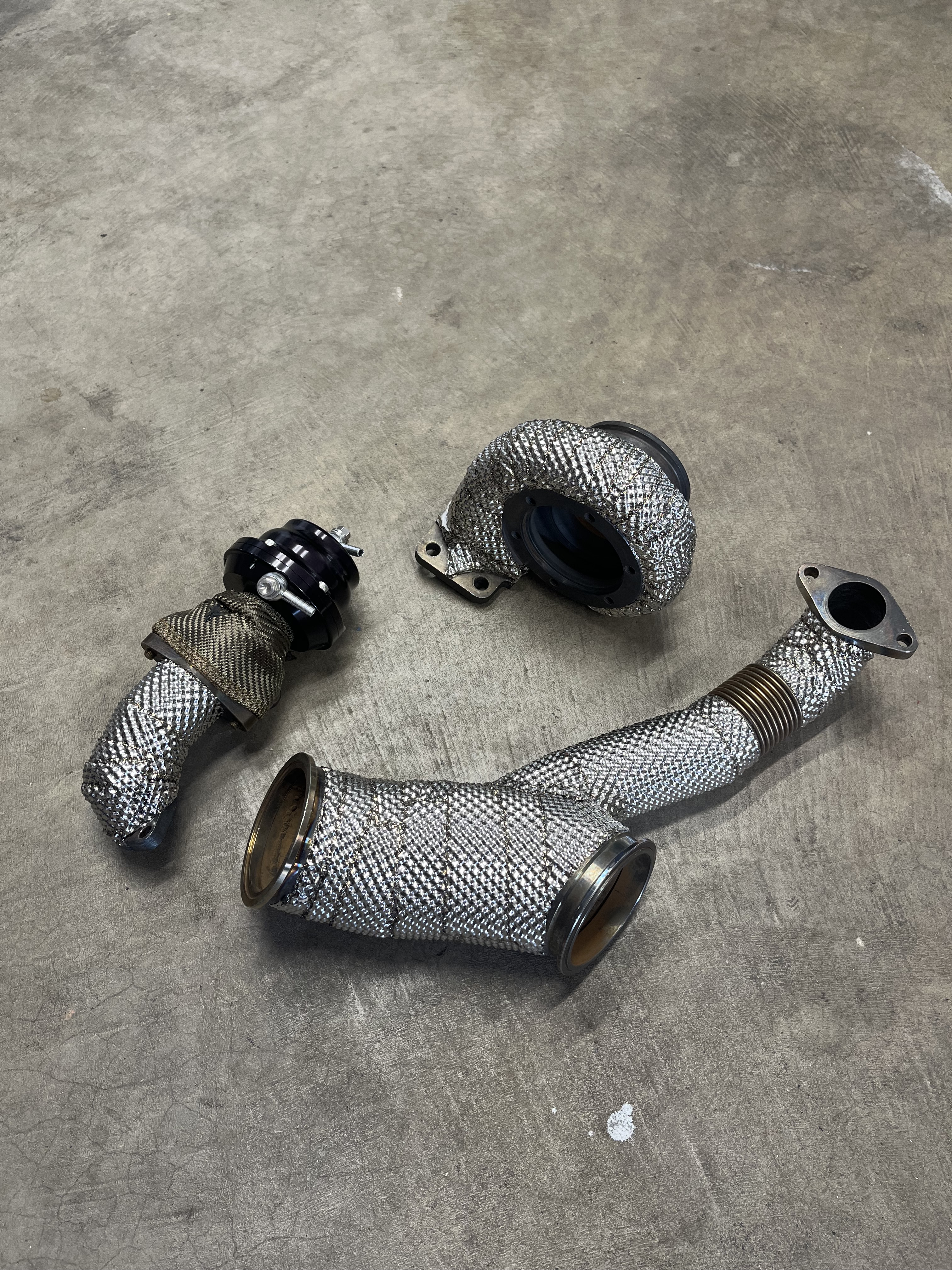

    So, While we are in there its time to do something Ive always wanted to do but had no idea how to do it other than what Id seen online. Bought a cheap spot welder off amazon and let it rip.

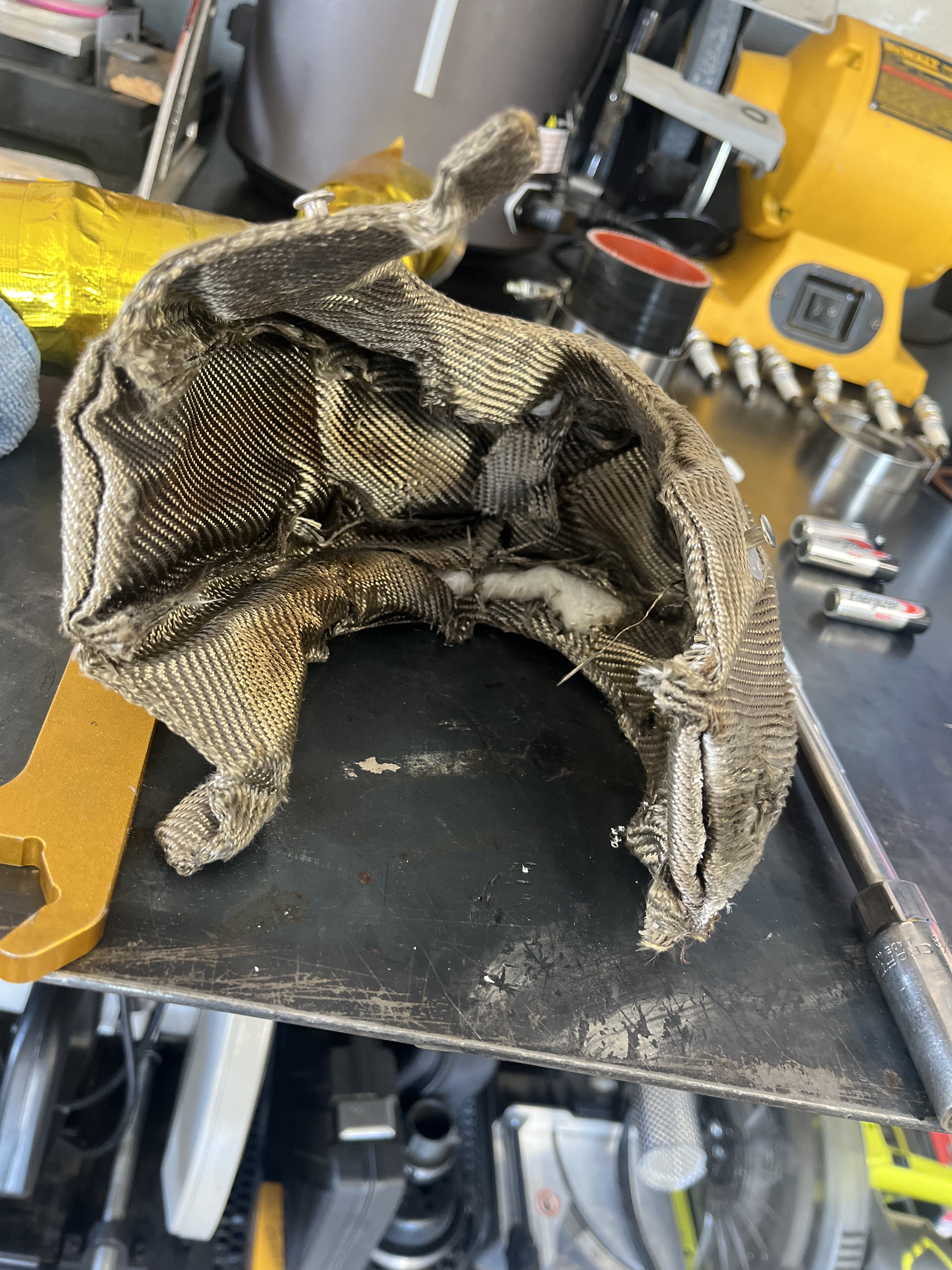

    All previous attempts at wrapping exhaust with fiberglass based material has failed. Turbo blanket fell apart in my hands during removal and all the exhaust wrap is shot.
    Here is the blanket completely destroyed from heat cycling.
    Using 1/2 inch cilica based insulation and stainless embossed steel sheet to build a better quality heat barrier should hopefully last longer and work better.
    Note: I still have heat problems in the engine bay. Dyno session 3 with new injectors melted more of my firewall insulation. Yay. Smells like burning crayons.
    The new insulation on all exhaust system parts will handle a 2200 degree constant heat exposure. The manifold and main section of the exhaust still needs to be done. The process is very time consuming. I have probably done over 50,000 individual spot welds so far.
    Here is the result. There are a few areas I am not happy with. This is my first time doing this.
    Replacement manifold gaskets and T3 gasket will now be solid copper. My previous heat shielding made from embossed sheet will no longer cover the exhaust manifold. The block shielding will stay in place as extra insurance.

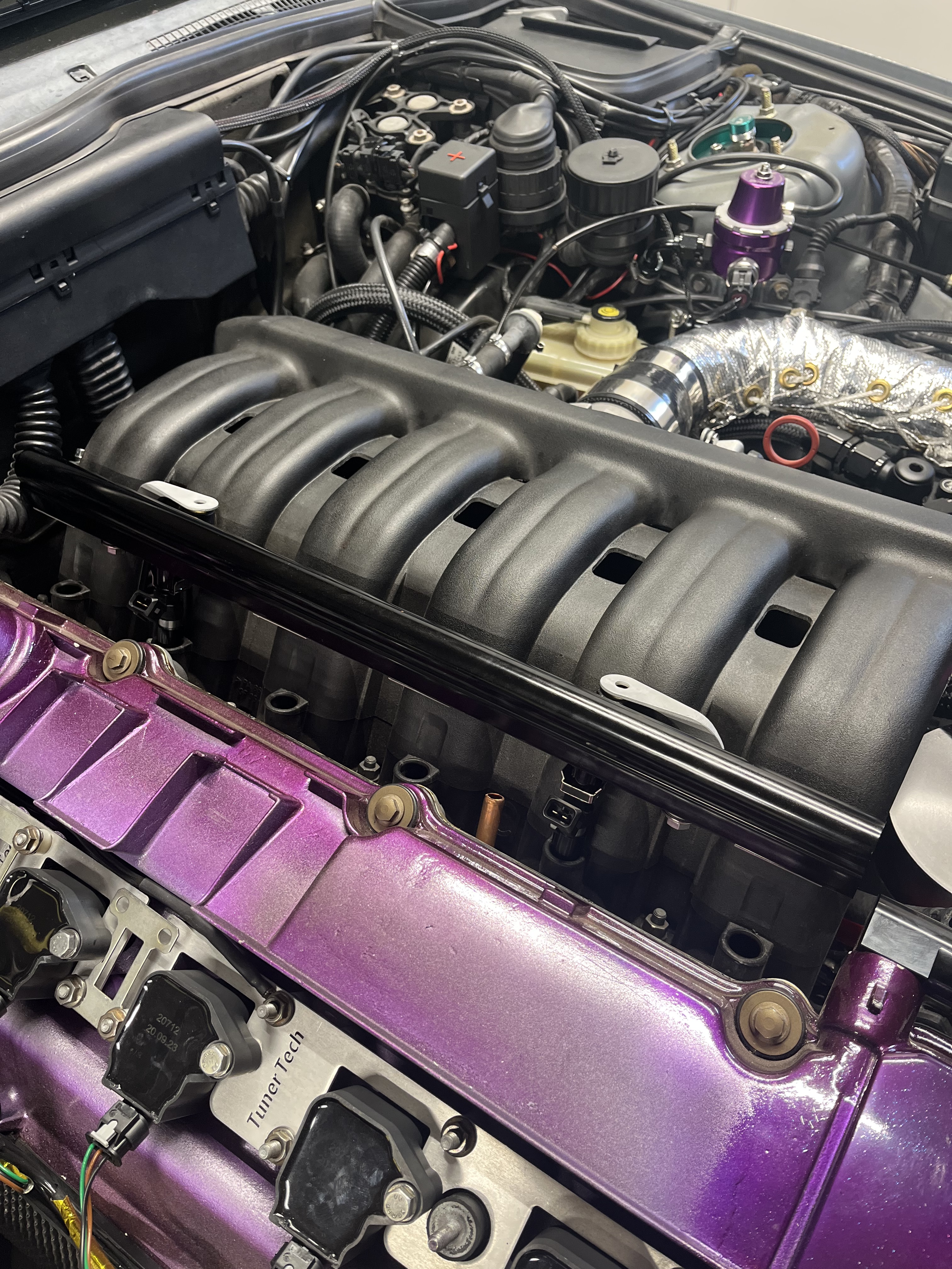

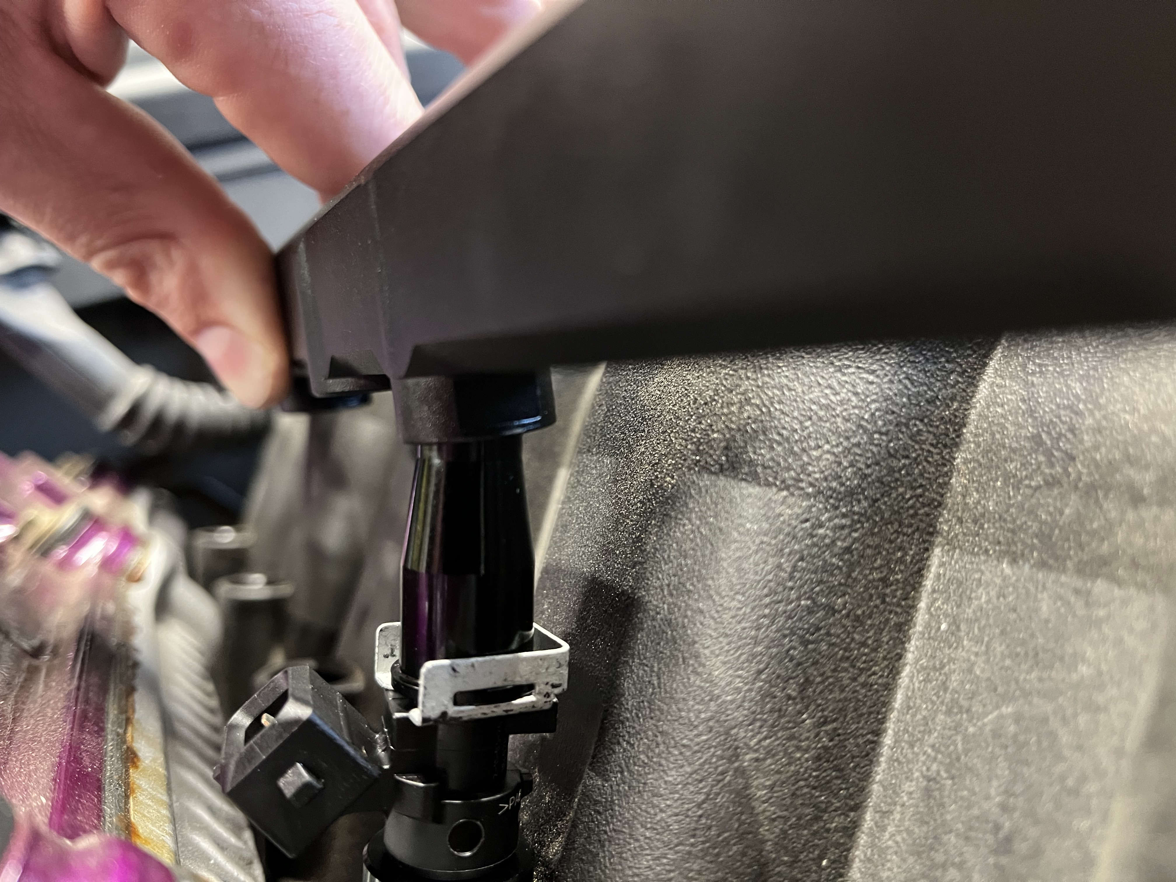

    A while back I ordered a Radium fuel rail with plans to install it with new injectors. Removing the stock rails meant changing all fuel lines to AN 6. The stock radium rail designed for m50 does not fit. The mounting was incorrect and I could not get the rail to sit correctly without being cockeyed. I didnt want a fuel leak to burn my car to the ground so I returned it and found this no name ebay setup that worked exceptionally well. It was less expensive too.
    Shots of Raduim rail fitment (overpriced junk)
    Heres a couple of the new injectors in the new rail. The only downside with the new rail is the fitment of the fuel rail beauty cover. I will have to fabricate some custom brackets to mount it as I want to keep the stock fuel rail cover.

      A few shots of the SPA manifold shielding finished. Still have exhaust center section to do from the downpipe to the resonator. I had to recess each runner so the exhaust studs will clear the insulation.
