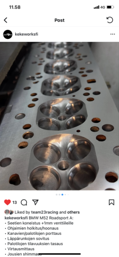

    Headwork done, 285CFM is more than any size or form of M/S5X bottom end can fully utilize. These have enormous potential compared to M20.

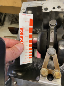

              #126

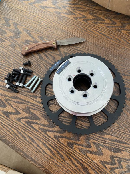

                          Not much progress, but at least damper solution arrived.

                            #133
                            looks more like an anti vibration damper

                              #134

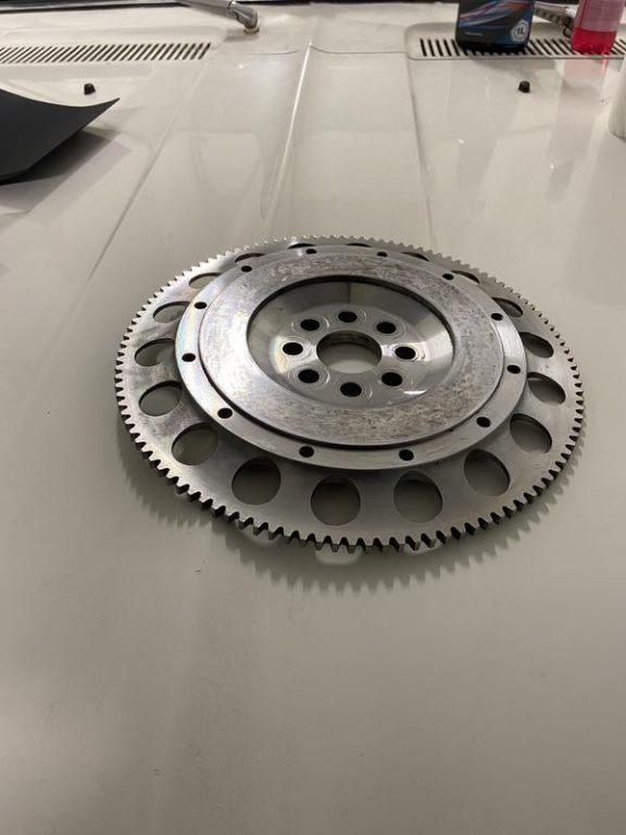

                              I'm struggling with correct vocabulary!
                              Also bought one flywheel candidate, but not sure what is my clutch/gearbox combination. I'd like to invest to proper 5/6 speed H-pattern dogbox, but reluctant to go forward with the investment. Only alternative is to put GS6-37BZ I already have, but it is quite slow to shift. And requires probably different flywheel.

                                #135
                                i just meant it doesnt look like it will provide much damping
