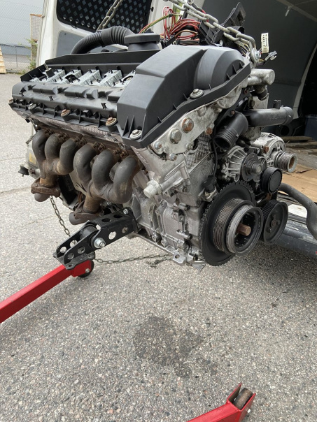

            After season 2024 I came to conclusion that my path with M20 engine platform is done. I'm 100hp behind my competitors and there are two main scenarios how to catch that: going 24v or 2.0 litre turbo. I know by experience that turbos bring lot of challenges to heat management and it is hell to drive, so my choise is 24v, specially M52 aluminium block.
            I started by sourcing used M52B25 and dismantled it to pieces to understand the basics. Head went to porting process.

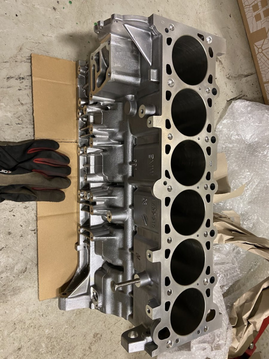

            Nikasil block was worn out ( deck height 210mm btw ) so I purchased new block with iron liners
            Engine basic specs will be
            85,8 stroke
            84 bore
            2850cc
            Forged pistons
            140mm H-beam rods
            Cat Cams valvetrain
            M3 itb intake system with adapter
            Headers
            I'm still struggling to invest to dry sump but all experts recommend that because engine likely needs to rev up to 9000. There is lot to learn. All information is appreciated!
