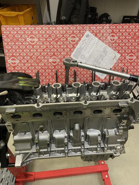

        Head is torqued. It was really scary experience to turn the last 90 degrees to aluminium block.

          Did you timecert it? Id would have considered studs. :)
          What cams are you running?

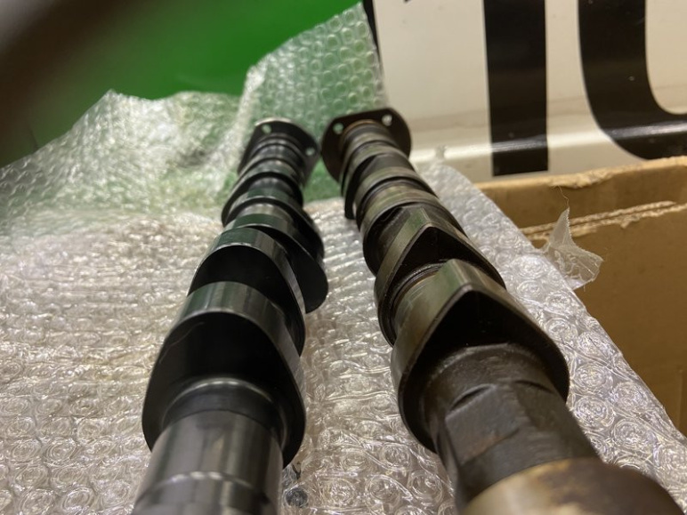

            I did not do anything for the threads. I feel I should, but block is new so I think it will be fine.
            Cams are Cat Cams custom grind. Image just for reference.. My 350hp imaginary target is of course crank hp. Many achieve that here when M52B28 engine is done properly for track or rally. As 350 wheel horsepower measured on a calibrated rolling road dyno it would mean +400 DIN HP from crank which is somewhat unrealistic for 2850cc engine unless it produces peak power above 9000.
            What does it mean actually going RRD-route? Head / Bottom end / cams ? They make impressive engines, but I don't see many posts from them that would explain details or results. As engineering point of view I'd be very interested about that.
                Mine was absolutely terrifying experience when it suddenly got very easy... the timecert spun and we had to rebuild again... PTSD lol

                  I think the stock proper length alu block bolts are the way to go unless you're going 500+. I think Pazi still runs them on his turbo car.
                  Maybe there are proper length studs out now, I kind of stopped paying attention a few years back.

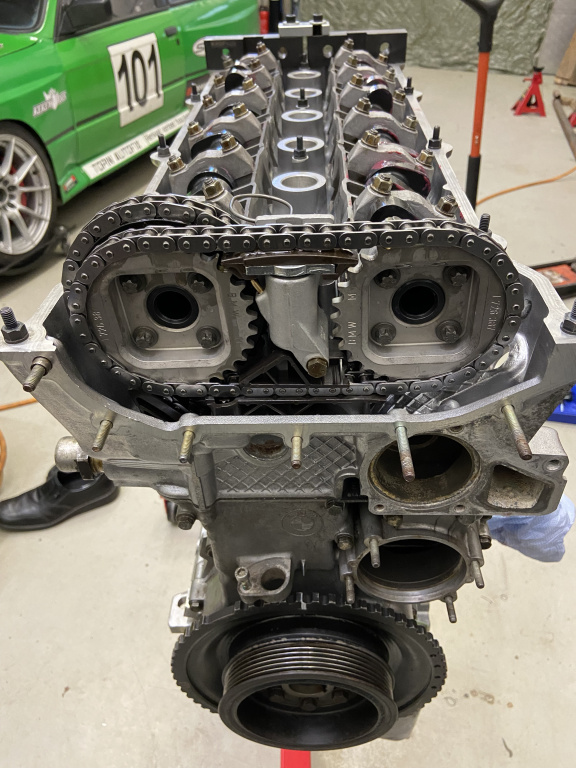

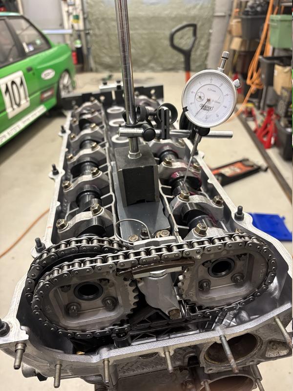

                      Here we are now. Next some cam timing. I must figure out how to mount dial gauge.

                        Mounting dial gauge was not so simple. There is not much room between cam lobes and cam girdle caps. So I had to do some adapters.
