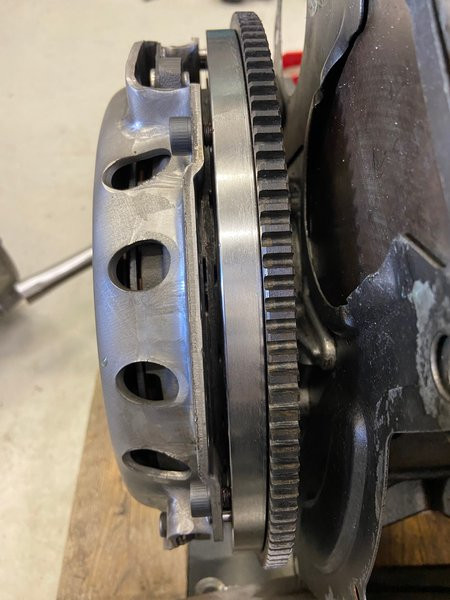

                  Engine runs nicely, responds very well to throttle with new light flywheel. But I hitted problems with clutch. Previously cluch disengaged very low, almost at level of gear grinding. Now it does not disengage at all no matter what I try.
                  So my conclusion is that the release bearing might be wrong for this combination. Engine has 528E bellhousing and unknown throwout bearing, very likely from E30 325i. Clutch is Sachs 618 and organic disc. Slightly stepped flywheel made for M20.
                  • moatilliatta
                    • 6152
                    #84
                    There is are 2 different depths depending on DMF flywheel for gearbox's. Maybe try 323 TO bearing with single mass flywheel?
                    @Zakspeed_US
                    • hasa
                      • May 2013
                      • 307
                      #85
                      Yes this is my assumption. I found old thread from this forum explaining the problem. (30mm vs 25mm high bearing)

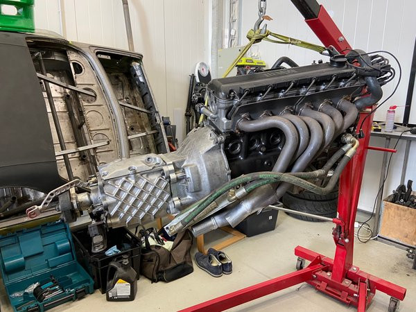

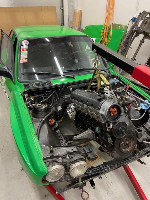

                        I lifted the boy out
                        Then I found out serious installation error... fortunately clutch did not work, as this would have led to serious disaster.

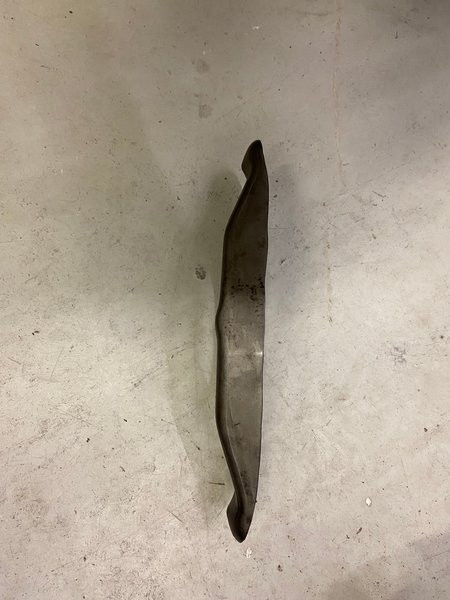

                          Clutch fork side profile looks odd, but I can't say if it's ok or not. I don't have any reference part. Throwout bearing was wrong version (25mm) as expected.
