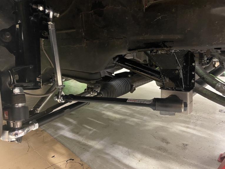

        Clutch seem to work at least when running on jack stands. So next mod is the front stabilizer. 1.5 weeks to next races.

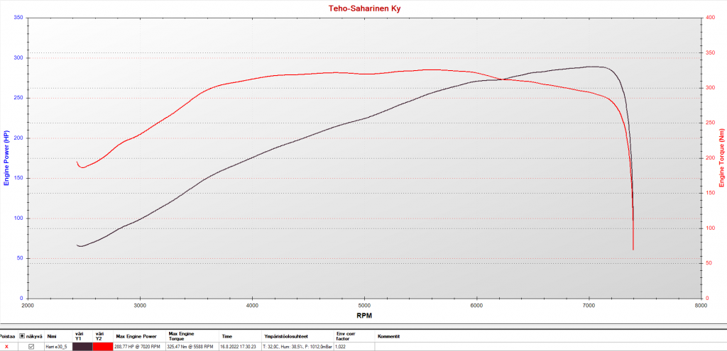

                      BNR alternator works great. Voltage stays over 14 in all situations.
                      I have also been debugging the crank trigger problem. New sensor made no difference, but then I increased the air gap up to 1.85mm and engine ran well to the redline 7500rpm.
                      By looking injection time curve and lambda it looks that engine would love even more revs. RHD roller rocker kid would now help…

                                #105
                                Click image for larger version  Name:	61AB5B0C-DB8A-4D9B-B1EB-9091B69672A9.png Views:	0 Size:	194.8 KB ID:	10065266 Dyno day result was something I expected from log data. 3 degrees more ignition advance gained 10hp compared to my guesstimates. Values are bhp as we tend to measure. Unfortunately raw whp is not included in graphs but numbers aren’t comparable between dynos anyway.
                                Click image for larger version  Name:	61AB5B0C-DB8A-4D9B-B1EB-9091B69672A9.png Views:	0 Size:	194.8 KB ID:	10065265
