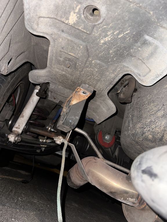

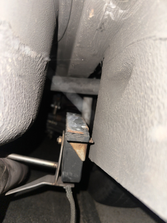

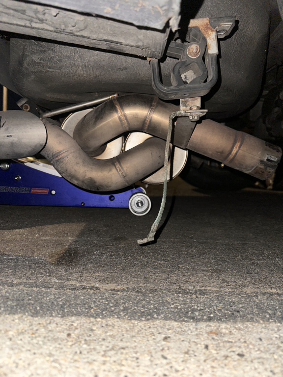

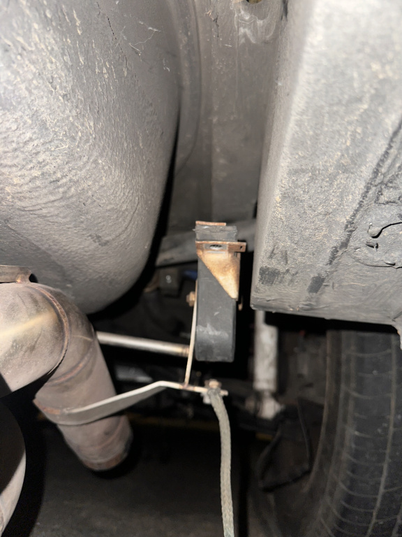

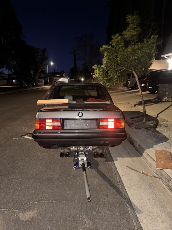

    So I have this spare meisterschaft exhaust from my E92 M3 and my plan was to sell it but then I got the idea of throwing it on my E30 instead it’s a 1989 325i 5 speed ⚙️, the meisterschaft exhaust piping is 3 inches wide I believe I will double check to make sure but my question is by throwing it on my E30 will I only be adding weight and losing back pressure? I have a fully built M20 2.7 stroker and well I have my E30 built/ still improving for the track so I’m using always in the high rpm’s . Here are some photos I took of a test fit on my spare part out E30 . I would also have to make custom exhaust hangers , here are the photos

    Also mostly curious to see what it would sound like after all the Meisterschaft is meant for the S65 but let me know what you guys think or if anyone has done anything similar? Or does it just make the car look funny ? I would like to hear other people’s opinion as well because I’m no expert and well I always seem to find good help here !

      3 inches is too big for an m20 NA
      You'll lose that low end torque, but if you're only driving it up on the top end, then I guess you wont really feel it. Might drone really bad too with the larger piping.
      Are you going to have to chop up the spare tire well?

        I wouldn't worry about a catback harming torque all that much, but it's probably going to sound bad. Big exhausts on small NA engines tend to just crank the rasp up to maximum, and butchering your spare tire well to fit it... Just sell the exhaust and put something reasonable on the car. You will not make enough power to need a 3" exhaust with an NA M20 build.

              Just dump it into a 2.5 inch single pipe after the cat and put a straight through muffler on the back and that's gonna be as good as it gets
              Valvetronic makes a nice universal one, so you can at least chose when to be annoying lol
