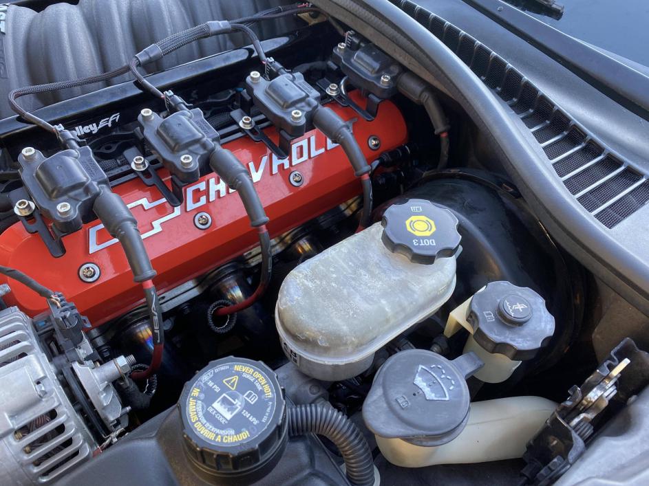

    Your first symptom, like nando says, is going to be brake fluid boiling and complete loss of braking force. Every time I get stressed out from the clearances on these projects that are cobbled together I go back and look at the engine bays where the components came from. Look at the engine bay from wherever your V8 swap came from... if the distance is similar, you'll be fine.

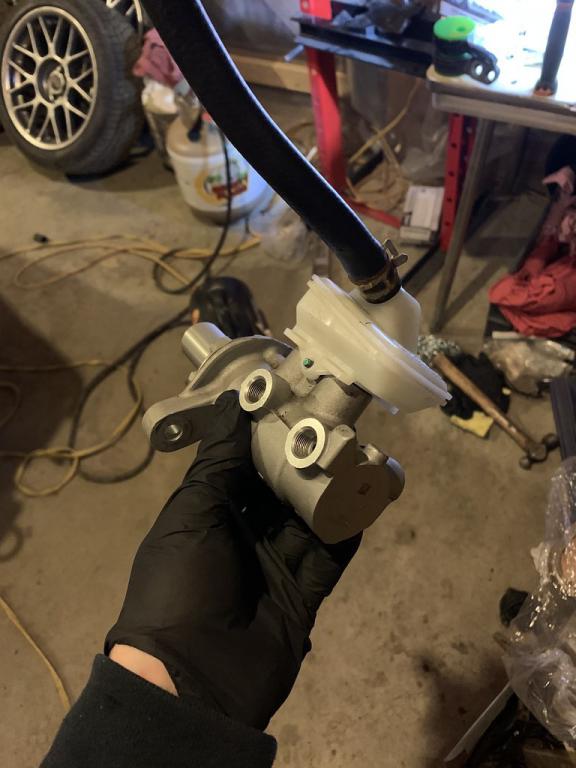

              #96
              Here's the right-hand-drive master with some adapters that I believe will work. I haven't had the e30 lines connected, but I believe I have the fittings correct on either end.

                  • nando
                    • 34844
                    #99
                    yeah, the wiring is identical. Really, even the MCs are the same - they just drill/tap one side or the other depending on LHD or RHD. It's too bad there's no "realoem" for Tesla, because finding the RHD masters is basically impossible (or extremely expensive).
                    I watched for months before picking up an LHD setup with the pigtail harness. Partially because it was cheap, and partially because it had the harness. RHD ones were 5x as expensive or worse, looked like they were dredged from the bottom of the Atlantic Ocean, and none of them came with pigtails..

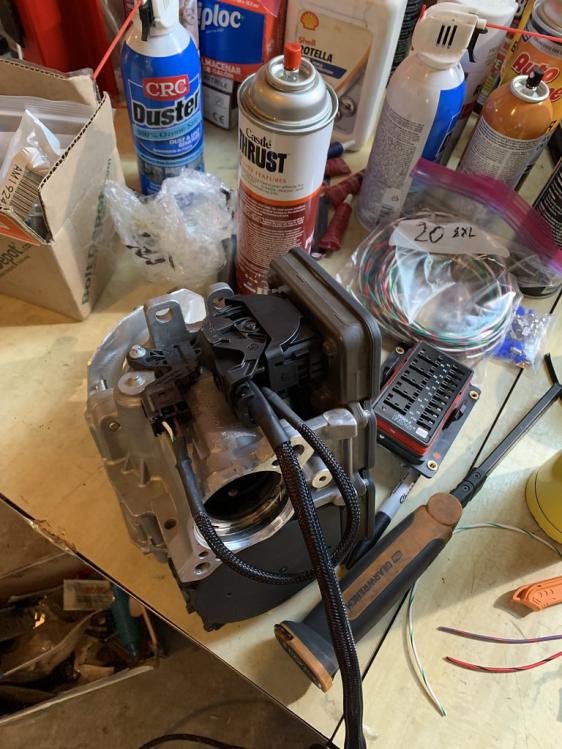

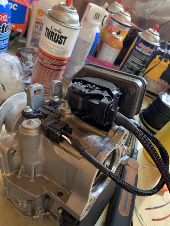

                      Reminder for anyone who is waiting for one with pigtails: call a yard that dismantles Teslas... when I did this they were happy to cut the wires on one when they took the booster out. The plugs are just scrapped.
                      • iman53
                        • Sep 2016
                        • 47
                        #101
                        I made my own harness which looks pretty nice and wasn't at all difficult. the kit is pretty affordable, this is the one I used:
                        https://www.ebay.com/itm/iBooster-Co...AAAOSwECtfvjdO
                        Anybody can do it if you have the crimpers and if you don't they aren't that expensive either. it looks better than a bunch of crimp connectors IMO. However, using a cut plug is undoubtedly cheaper.
ID:	9978471Click image for larger version
