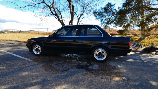

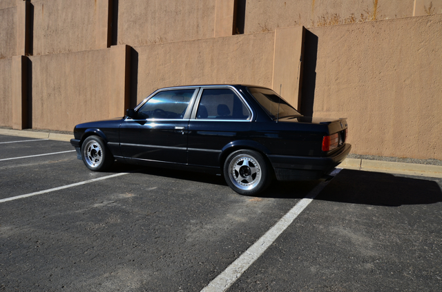

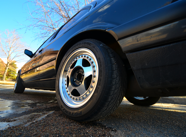

          The tires that came on them were undersized so that is why it looks goofy.

              BTW Brad I think they look good. I like the black centers on your car.

                Damn Brad that looks really nice.. I think you should keep them... third shot looks awesome!!!

                  I take back what I said earlier, those wheels are awesome.
