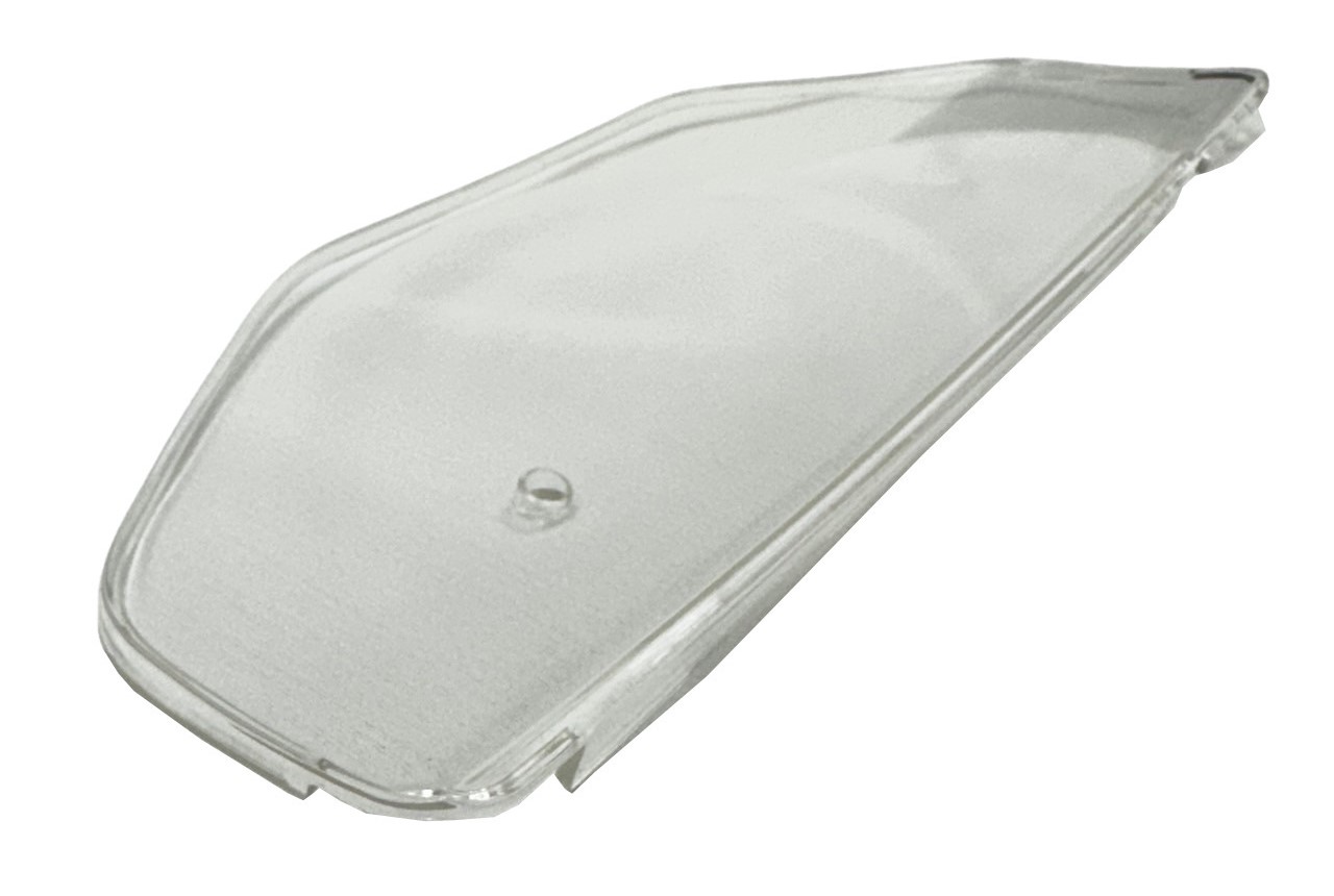

                  There are new plastic covers.
                  They cost $70-75.
                  High quality reproduction acrylic glass for your E30s instrument cluster. Compatible with OE part number 62111377340. Fits all E30s except 316.
                  https://www.ebay.com/itm/404979946437

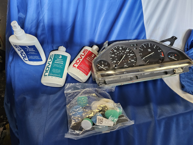

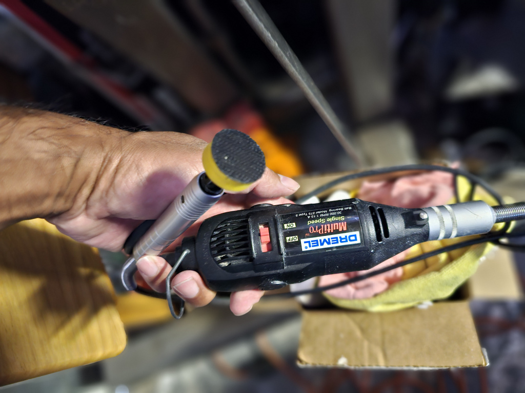

                        Just to update, my mistake was wet sanding (even with an ultra fine grit) and using abrasive compounds. Using these compounds left it clear at first glance but once the sun hit it, the micro scratches and spiderwebbing became visible and was driving me crazy. With this realization, I took extra covers that have never been sanded or polished and started over. They had some minor scratches but nothing too deep. I used the Novus 1,2,3 process with a small rotary disc on a dremel with a pencil grip accessory that gave me more control. Previously, I was using a 3-4" DA polisher. First heavy cut #3 with wool, then lighter cut #2 with foam. Once I was happy with the clarity, I wiped it down with the #1 Novus anti static cleaner on a clean heavy microfiber cloth. There are still some imperfections but I'd rather live with a few of those than a thousand micro scratches all over the cluster! I still may order new cluster lenses depending on how good these turn out. I'll update this thread with pics later.

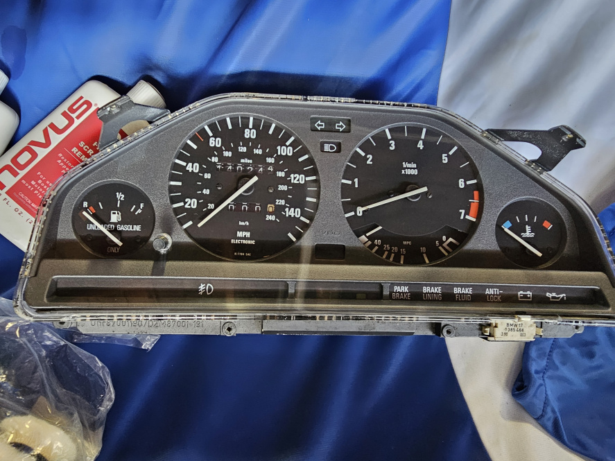

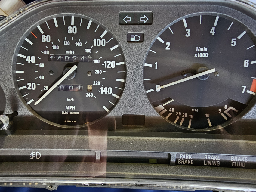

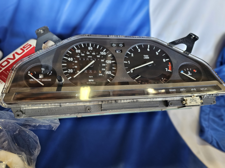

                          Lets see the tools & compounds you used too
                          Simon
                          Current Cars:
                          -1966 Blue Boat
                          -1969 Red VW
                          -1986 White BMW
                          -2006 Green Thing
                          Make R3V Great Again -2020
                          • reelizmpro
                            • 9553
                            Click image for larger version  Name:	20251007_122534.jpg Views:	0 Size:	202.7 KB ID:	10147198 Click image for larger version  Name:	20251007_122555.jpg Views:	0 Size:	229.0 KB ID:	10147199 Click image for larger version  Name:	20251007_122603.jpg Views:	0 Size:	272.7 KB ID:	10147200 Click image for larger version  Name:	20251007_122613.jpg Views:	0 Size:	278.4 KB ID:	10147201

                              Here is the special dremel with extension attachment. It's the same thing that manicurists use in the nail salon. My mother used to do nails so I borrowed it from her. It actually works perfectly for this job, since I can be more precise with the location and how much pressure to apply. It also has a foot pedal so I can change the speed. I got the pads and attachment plate from amazon. Initially, I was using this to polish the clusters while still installed in the car but I couldn't really do a good job since the cluster is recessed into the dash. You really have to remove the cluster or the plastic cover to really do a good job.
                              Click image for larger version  Name:	20251007_122415.jpg Views:	0 Size:	231.2 KB ID:	10147208
