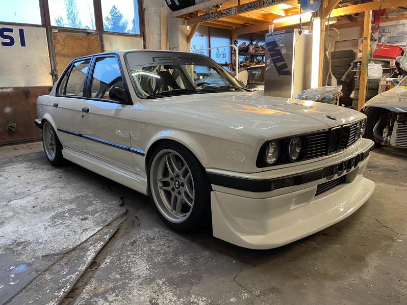

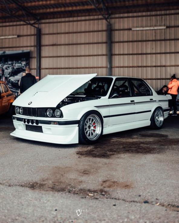

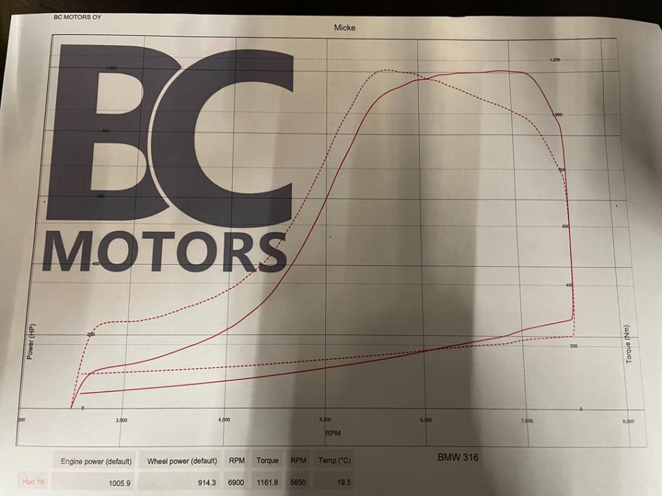

    Maybe I should update this, back on the road after a few years. Currently making 1005hp and 1161nm (856ft/lb in american) at 2.6bar of boost (37-38psi), these are crank hp. Sure, could make some more by just turning it up a bit but this is enough for the street.
    Finished the rear widebody, pulled the front fenders a bit behind the wheels to match. This had to be done anyways to be able to turn without the 225/45-17s hitting the sideskirts and fenders.
    A lot to be done during the winter: some interior changes, drag wing, maybe a rear diffuser and other small things. Some pics, enjoy:
    Link to first picture, a bit bigger: https://micke.kuvat.fi/kuvat/e30%203...jpeg?img=img4k

      I had not come across your thread before now. very nicely done. I liked the tictac era, but much prefer this new look. Very nicely done on the widebody, that is some out of the box DIY thinking and the end result appears to be great. I'm not sure about that new front splitter but perhaps alludes to the craziness lurking under the hood haha.
      Must be a hoot to drive.

        I'll make version 2.0 of the front bumper / splitter this winter, some small changes but nothing major
        It's a handful to drive, the welded diff doesn't help at all. But changes planned for the diff and rear suspension also..

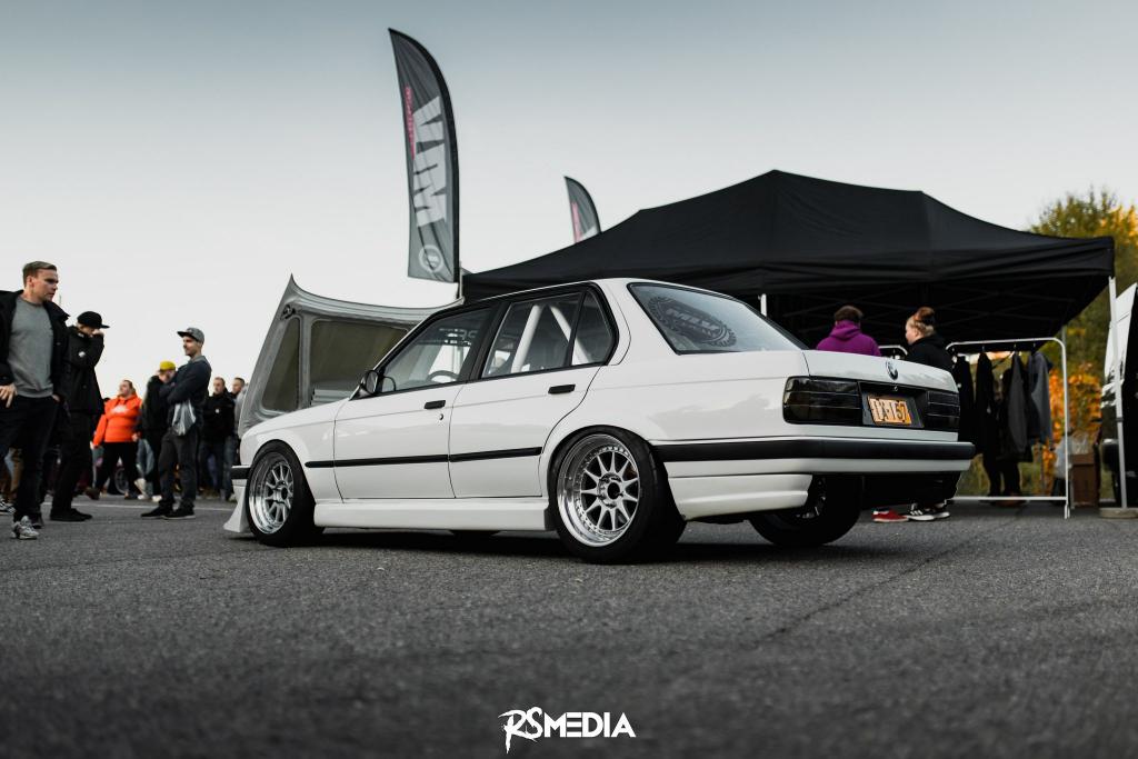

          I like so many things about this build. The TicTac livery was great, everything about the powerplant too.
          I've never seen someone do a widebody like that, and I reaaaally like how you did that.
          I assume you cut out at the bottom and inside the wheelwell somewhere also? Any cuts at the back?
                Thanks!
                It was cut all the way from the b-pillar to the tail lights. Underside of the rocker panels the whole length of the rear doors, all the way around the inner wheelwell , and continued all the way to the rear panel under the bumper / taillights. And ofcourse the door jamb and inside of the rear doors also..

                  Thank you for the info!
                  If you find any more pics of the widebody work that was done, I'm sure they'd be well received here haha
                  Did you have to modify the rear bumper at all, or can it just bend enough to fit?

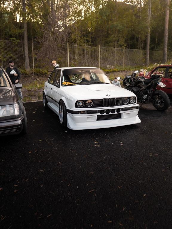

                    The rear bumper fits without any mods!

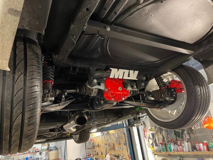

                    Some more pictures, first one shows the quarters quite good. (yes, the rear door trim is broken, won't line up perfectly with the front door trim but I'm getting another one..) Test fitted my Style37 too, fronts are 9" and rears 9.5". Hoping to fit some 285/30 or something similar in the rear, I don't think 18"s look big at all on this car..

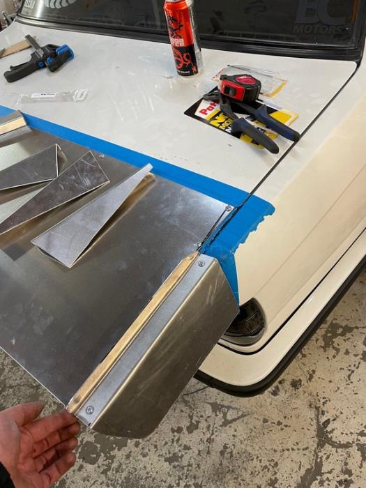

                        Minor updates:

                          • mikey.antonakakis
                            • Dec 2019
                            • 256
                            #58
                            Love it!
                            • moatilliatta
                              • 6121
                              #59
                              Whats it do down the strip?
                              @Zakspeed_US
                              • varg
                                Florida Turbo Man
                                • May 2014
                                • 3325
                                #60
                                Is that a 210mm differential? I have a 210 question that I haven't yet seen an answer to. How does the carrier differ between the low ratios and higher ratios like the 188? I.e. 2.93 uses a different carrier than 3.64 or another more common ratio. If it does, where is the dividing line? I've been looking for a 210mm diff for my E34 but have been balking because LSDs are rare enough without taking into account the low ratio, which I have never seen for sale anywhere, ebay or otherwise.
                                IG @turbovarg
                                '91 318is, M20 turbo
