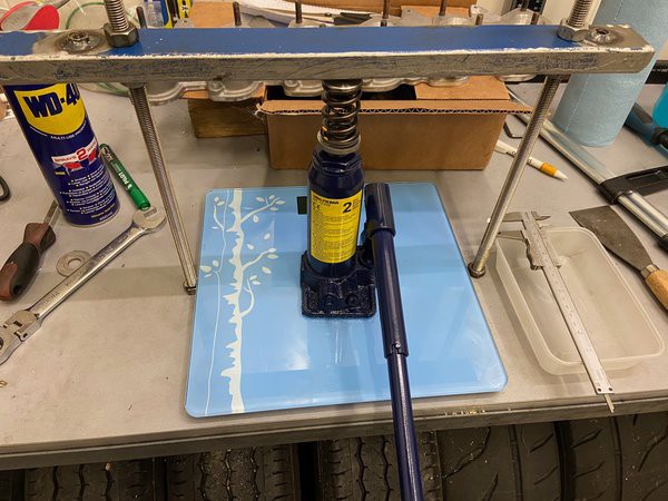

      DIY tool for some valve spring research
