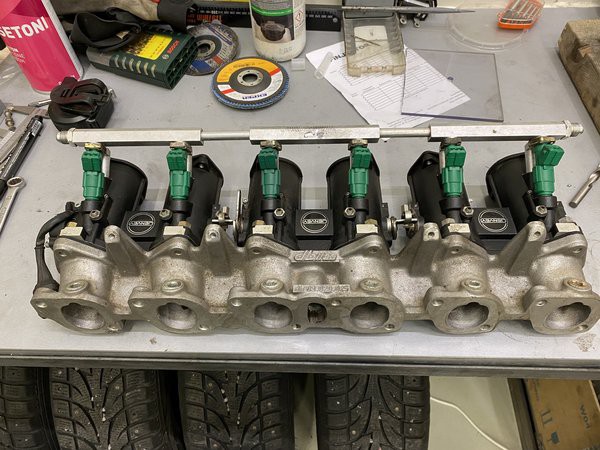

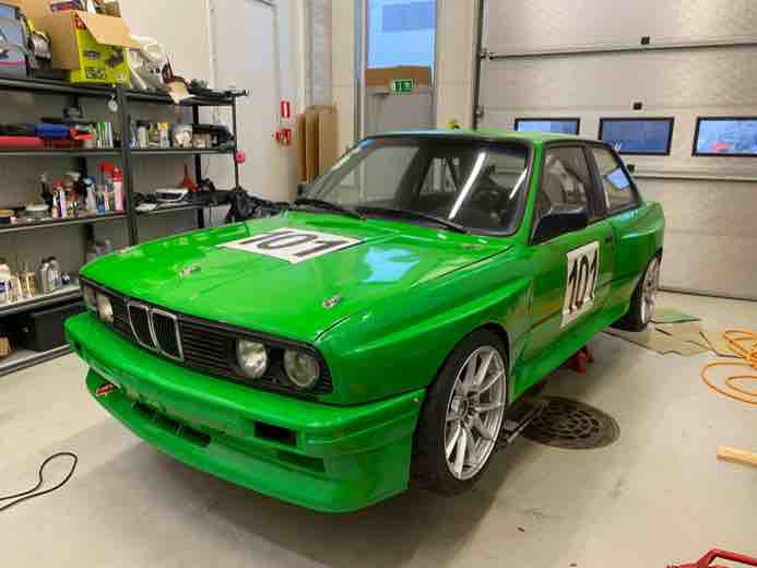

                          Season is over. Conclusions:

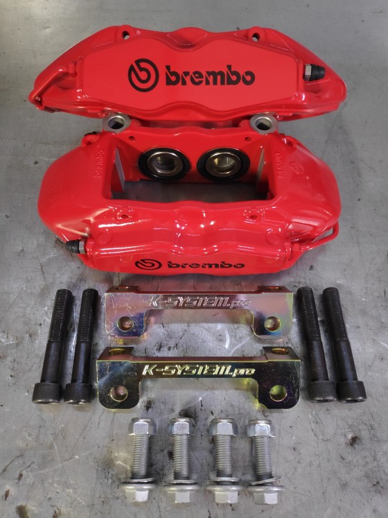

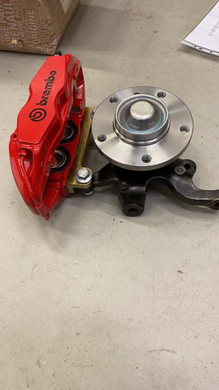

                          • Car needs brakes. Floating calipers seem not to work in my setup. I ordered 4-piston kit that should solve the problem, but requires swapping to Non-M knuckles, which is drawback.
                          • Car needs more power. I believe 45mm secondaries in the headers could be one thing preventing engine to produce power after 6000rpm. Stock head maybe too.
                          Solutions are on the way
                          • 4 piston kit
                          • New head with 195cfm@28"
                          • Cam upgrade 304 -> ?
                          • Major rework of dBilas intakes to fit

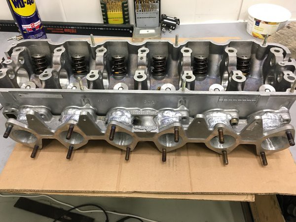

                            Head and manifold came back. Head flows about 195cfm and the intake is matched to the ports (which required welding).

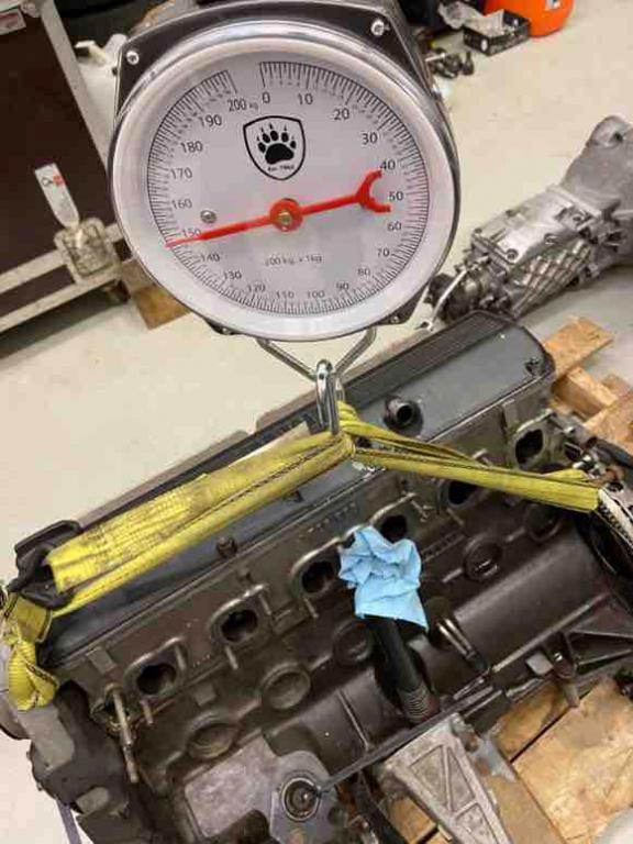

                              #59
                              Running engine weighs about 156kg Sent from my iPhone using Tapatalk
