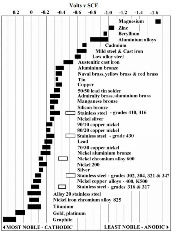

          Working on an e90 rn and BMW likes to use a lot of aluminum hardware on these n5Xs.
          Customer came in for an engine vibration... Lift the car up and I see the oil pan resting on the rack. Okay, should be come collapsed mounts, right?
          Nope, the aluminum bolts on the drivers side motor mount arm all ripped off and the aluminum bolts are sheared off in the block, which is right next to the frame. Plus all the aluminum hardware is TTY, so those bolts arent going to be that easy to take out.
          Fs in the chat boys, this lady is fucked.
          REALLY dumb on BMWs part for not making the 8 bolts that hold the whole ass engine up out of steel.
          I am always interested in the rationale behind engineering decisions though and would love to read the decision making process behind it. My guess is that it's something to do with galvanic corrosion since those blocks are a Magnesium alloy
          Click image for larger version  Name:	galvanic%20series%20noble%20metals.jpg Views:	0 Size:	66.6 KB ID:	9888000
          If an N5X car with steel bolts in its N5X block sees winter use that car might wind up in the scrapyard faster just because of the repair alone

              Theirs at least 3 pages of discussion in the N52 swap thread regarding the corrosion issue with motor mount arms. I'm wondering what she did to shear them... alot of cars N5x motors have seen alot of abuse and I've never heard of this problem.
