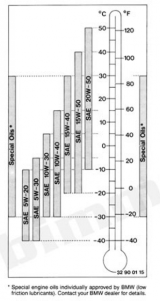

                      Can anyone give me an explanation as to why my oil pressure is gradually (over months) dropping, from 60psi on start up (according to a post of mine from a year ago) and 9psi hot idle, now down to about 55psi cold, and about 6psi hot, that doesn't include impending engine failure? Looked at my oil pressure gauge coming home the other day and noticed it was lower than usual (call it about 7.5psi hot in recent months). Due for an oil change, but I've had so many issues with the motors in my E30 that this is making me nervous. Don't wanna make a separate thread just yet, wanna do an oil change and move up to 15w40 I think to see what that does.

                        Oil is losing viscosity with age probably. Maybe even fuel diluted. What kind of oil pressure gauge are you using? I've had annoying issues with both oil pressure gauges I've had. The intellitronix gauge I have now has never shown a number between 8 and 18. It's pretty annoying that even a gauge that isn't a chinabay cheapo has these issues. I would not recommend buying one. I hate how rare oil pressure gauges are as a standard feature in cars.
                        I'm looking forward to seeing the oil analysis results for my recent oil change. I've been using Mobil1 15W50 since the installation of the new turbo along with the new feed setup and kludged oil cooler installation.

                          It's a VDO gauge, 0-100PSI. I considered that maybe the oil had become thinner with age, but I wasn't sure if that was something that happened, but it sounds like it is. I forgot to mention my E30 has had some starting issues lately, kinda hunts for idle, but ends up just stalling because the RPMs drop too low. Based on that chart, I think 15w50 would be ideal. My E30 is a 3 season car, so typical outside temps are above freezing. I'm considering doing an oil analysis when I change out the oil.
